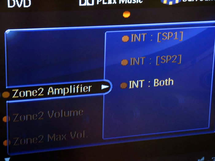

IMG_0021001I was quite taken by the full multi zone / source audio features bestowed upon this receiver. Not only did it have the ability to serve three independent zones of audio, but it also had power amp assignability of four of the internal amps (SP1 and SP2) for either Zone 2 or 3 or two for both. Best of all, you don’t even have to power up the main zone to get music going to Zone 2 or Zone 3. I loved the fact that you could power up Zone 2 or 3 independently and adjust level control and input selection all accessible on the front panel of the receiver via Zone on/off and Zone control buttons.
In my setup, I configured all four of the Yamaha internal amps to Zone 2 and used two channels of my Emotiva MPS-1 to driver two sets of outdoor speakers for Zone 3. I then connected four amps from my Emotiva to the surround side and back channels of the RX-V2700. In this configuration, I was severing a total of four indoor speakers on zone 2 (dining room, guest room) and four outdoor speakers on Zone 3 (2 frontyard and 2 backyard). Thanks to the net streaming features of the RX-V2700, each zone had independent source control. The only negative was I was limited to 5.1 in the main zone when either Zone 2 or Zone 3 were engaged, despite I had enough amplifiers to run a full 7.1 theater with all Zones active. Perhaps in future models, Yamaha can open this option up for people having the available amplifier channels.
It’s important to note, I found a rather unusual issue I’ve never encountered before when connecting my Emotiva MPS-1 7CH power amp to the RX-V2700. When I used the “Music Mode” trigger of my Emotiva to auto turn on/off the amplifier upon detection of a music signal, I heard a bizarre momentary sound (a whining alien buzz) emanate from my speakers powered by the Emotiva shortly after I turned off the RX-V2700. It was likely a result of power supply discharge from the Yamaha that seeped through the RX-V2700’s preamp outputs as a result of poor isolation from the muting relays. My work around was to use the 12V trigger which cut power to my amplifier instantaneously after I turned off the RX-V2700. 12V triggers are preferred to music mode types to avoid audio dropouts when your amplifier turn off during quite passages of the movie and tries to instantaneously engage back on. I suggest using the 12V trigger to avoid these issues altogether.

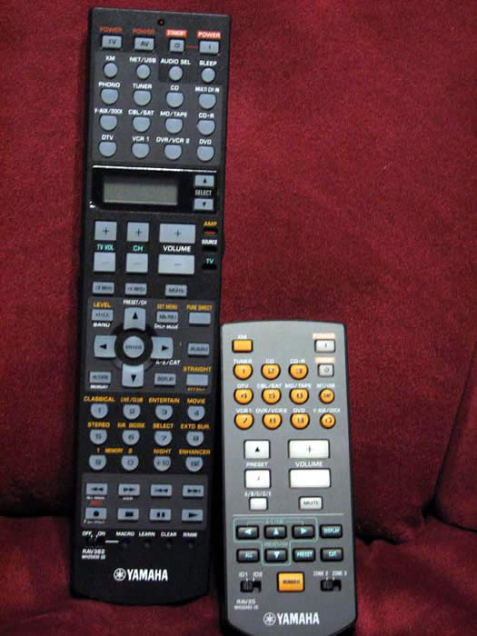

remoteThe RX-V2700 comes with two remote controls: one that operates the main zone (RAV362), and the other (RAV25) (which I refer to as "MiniMe") for Zone2/3 control. Not much has changed here since the last couple of generations. The RAV362 is a universal and learning type remote that is fairly intuitive to operate and program. All of the keys are backlit via a button located on the left side of the remote. A switch on the right side of the remote determines the functionality of buttons marked in orange while an LCD display window and up/down selection buttons allows the user to determine the function of the center navigation and play/stop functionality of the source currently being used. The remote has discrete keys for each input select and offers a hot key for channel trim adjustments, and DSP modes but unfortunately doesn’t do so for PLIIx modes. Overall, the remote has good tactile response and is easy to hold, but I recommend it as a support for the RX-V2700 and NOT the primary remote to operate your home theater. For that I suggest a Logitech Harmony or Universal Remote Control Inc type of product.
The RAV25 is a basic zone remote that allows you to select input, tuner presets, mute, volume and power on/off for each zone independently. You can toggle remote functions based on the remote ID# switch located at the bottom left of the remote. This is a handy little remote but the experienced installer would likely integrate an RF remote or touch pad at the zone location where audio is being fed.
