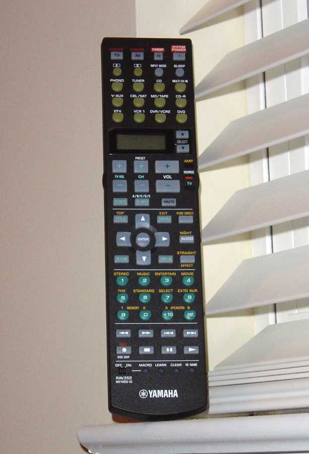

RAV 352 remote controlThe Yamaha RAV352 remote control has some great benefits and a few "why did they do that?" near misses:
  • Very easily programmed
  • Fits nicely in the hand, new thinner design
  • Dedicated receiver volume
  • Source switch for controlling inactive components
  • Seafoam button labels unreadable in dark, even with backlight
  • Backlight barely lights up keypad
  • Keypad does not adhere to standard layout
As I hinted at earlier, I liked what Yamaha had done with the RX-V2500's redesigned remote control. The RAV352 fits assertively in the hand so that most commonly used keys are positioned within easy reach of the thumb. This includes volume, channels, Menu, navigational and the Enter button. Even DSP functions are within easy reach without having to maneuver the remote control. The only drawback to that is that with a DVR I am constantly using the fast forward and rewind buttons - all of which are located below the keypad/DSP section.
The fact that all keys are now backlit (activated via a button on the left side of the remote) would be cause for small celebration except that the remote stopped just short of the first down and opted to include "sea foam" colored labels on many of the primary buttons - rendering them nearly invisible in the dark, even when backlit. One other thing to note is that the numeric keys (which are not arranged in the familiar 4 rows of 3 format) are also poorly and unevenly backlit. It's a crime. Perhaps all of the manufacturers are finally catching on to the fact that many remotes may be used in the dark, though apparently RX-V1500 owners will not be as fortunate to receive a fully backlit remote. I say light the remote hard , and light it up blue with low power, high-performance LEDs. If you're going to light it, make sure all the buttons are visible and that you can use the remote to summon for help in the event that you are lost at sea.
Programming the remote is simple. The only difficulty I had was that the programming buttons were somewhat good at eluding the tip of my ballpoint pen. Often times it would take me 4-5 tries to lock in a learned device. A paperclip may render this comment moot.
I also like the feel of the buttons themselves. The no-slip texture is easy on the hands and helps ensure you select the right buttons. Users of previous Yamaha remotes will need to get used to flipping the new AMP/SOURCE/TV switch which is a nice development that instantly directs remote control commands between the receiver, currently selected source, or television (as programmed into the DTV source.)
Separate power buttons for the receiver, source and television help ensure that you'll never mistakenly turn off the wrong device.
