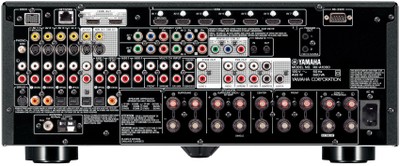

On the back, the receiver features seven (yes SEVEN!) HDMI inputs and two parallel HDMI outputs. Back are the S-video inputs for all inputs and there are WBT-style high-end 5-way binding posts in place of Yamaha's typical red and black plastic monstrosities we all love to hate. There are preamp outputs for 7.1 channels with dual (parallel) subwoofer outputs. Zone 2 has a preamp out, with analogue video support, and the dedicated Zones 3 (RX-A2000) and Zone 4 outputs (RX-A3000) are analogue audio only. The RX-A1000 has four component video inputs and a network jack for bringing audio in from the Internet or streaming from DLNA-certified sources (PCs). USB audio is also possible thanks to the front USB jack. Finally, an iPod dock connection (compatible with the YID-W10 Wireless Dock System for iPod/iPhone) and phono inputs make this about the most robust receiver we've seen from Yamaha yet - at this price point.
RX-A1000 rear
