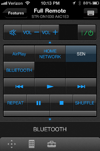

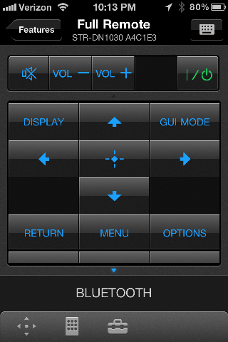

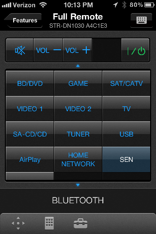

iOS Media Remote App
Sony’s Media Remote app is meant to turn your iOS device into a full-fledged remote control. It isn’t specific to the STR-DN1030, but actually supports a whole host of different Sony devices, such as their Blu-ray players and TVs. Depending on what type of device you are controlling, the app will give you a different set of options. Given that I was controlling the receiver, it gave me the choices of simple remote, full remote, and keyboard. The simple remote is a directional pad with return, menu, and options buttons. The full remote showed a list of almost every button on the original Sony remote. In order to see all of the buttons, you have to scroll up and down on the iPhone. Neither of these remote options worked better than the original remote, so I didn’t use the app often. I was excited to use the keyboard option in order to enter text into the receiver, but it just kept giving me an error and I never could get it to work. The Media Remote App does not show you what is currently playing on the receiver, or give you advanced control over network features. The Yamaha AV Controller App, for example, tends to be easier to navigate and allows for complete control, including browsing of DLNA devices and attached USB drives. The Media Remote App is far behind what other manufacturers offer.

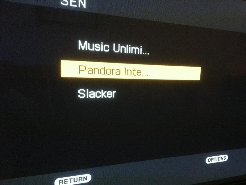

Sony Entertainment Network (vTuner, Music Unlimited, Slacker, and Pandora)
Sony’s decided to place vTuner (Internet radio), Music Unlimited (Sony’s music store), Slacker, and Pandora all under the umbrella term Sony Entertainment Network, or SEN. Fittingly, by pressing the “SEN” button on the remote, a list of the services is brought up on the TV. By including these services, Sony opened up the door for hours and hours of free music listening, which is something we at Audioholics are all for.
Before you can use the services, you must register the receiver with Sony. After that is out of the way, you can sync your current accounts with the receiver. Unfortunately, my experience using each of these SEN features was negatively impacted by a sluggish response, limited visibility of text (largely due to scrolling), and lack of visual cues to assist in menu navigation. Once I became used to the menu system, it worked decently, or maybe I just learned what services to avoid using. The sound quality of each service was great for background music, with the exception of some vTuner stations. I spent most of my time using Pandora because the user interface was the best out of the 4 music options. You are shown a simple list of available stations. It doesn’t show album artwork or give you the option to thumbs up/down or bookmark tracks, but you can add a new station. vTuner, Music Unlimited, and Slacker were very difficult to navigate, mostly because the GUI only showed 4 lines of scrolling text.  Each service consistently provided a good listening experience, but if you want to stream vTuner, Music Unlimited, or Slacker, I would recommend using a different device, such as a Blu-ray player.
