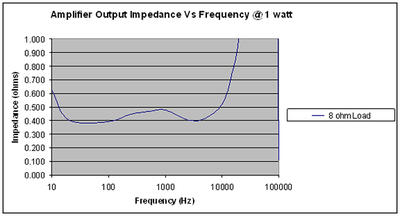

We measured the Sony STR-DA7100ES' output impedance vs. frequency at 1W. It stays relatively flat across the bandpass, but does increase dramatically starting around 15Hz and 15kHz. This is a higher than typical output impedance then we are accustomed to seeing, but not surprising given the amplifier topology (a side effect of the LPF of the output stage). Care should be taken however to mate this receiver with a speaker that has a relatively constant impedance profile to avoid frequency response variations or inconsistency in sound.

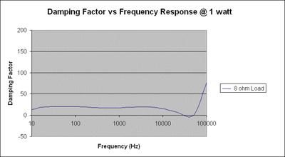

The damping factor of the receiver was pretty consistent at around 20, dipping down significantly around 50kHz. Again this is lower than typically seen on receivers with linear amps in this price class.

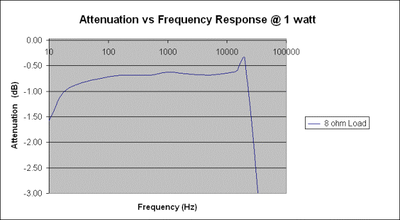

Measuring attenuation versus frequency, we can see the Sony starts to show some gain at just over 20kHz which then drops off as the analog toroidal low pass filters kick in above that point. On the low frequency side we're looking at a really flat response with a gentle roll off below 100Hz (we're talking about 1/4 dB) with a steep fall off below 20Hz.

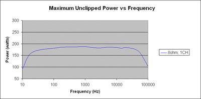

Wanting to get in a quick power measurement before we had to pack up the unit for Sony, we measured Max unclipped power into 8-ohms and showed that the Sony could easily drive a single channel from 40Hz to 20kHz at around 183 watts (20Hz was showing 162 watts).
