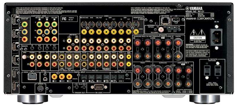

Back Panel View of the Yamaha RX-Z7
The RX-Z7 is certainly not connection deficient. The four HDMI inputs and two HDMI outputs are vertically aligned on the far left of the receiver with an additional HDMI input on the front panel. Component video connections are grouped in close proximity to the right of the HDMI with S-Video / Composite video horizontally located right of the component video connections.
There are 11 high quality WBT speaker connectors on this receiver where two pairs can be used for assigning the internal amps to other zones, or presence/back channels or bi-amplification for the main channels. iPod and Ethernet connections are available to support network and streaming functions. With six memory settings for the main zone and four for the other three zones, the sky is the limit with configurability not just for where you assign the speaker groups but how you customize and configure any parameter in the receiver. There are two switched power connections, and this receiver comes with a detachable power cord which is a real handy convenience during installation.
