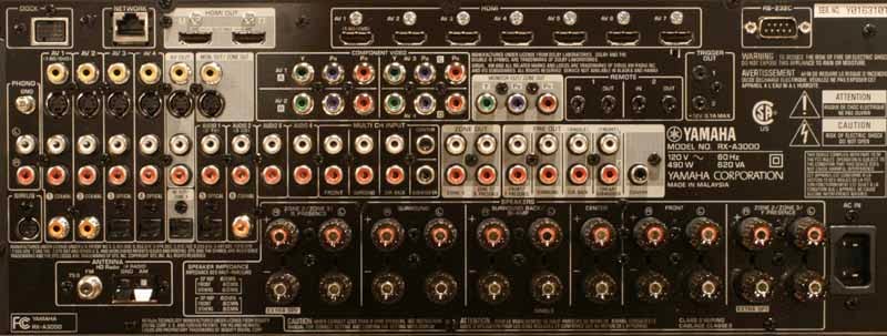

We ran a full suite of amplifier tests on this receiver below, but for now let's talk some more about features - cause there's a LOT of them. The receiver is packed with inputs and outputs. If you haven't yet gotten your head wrapped around just what this behemoth offers, we'll help you through that here. Take a look at the back of the RX-A3000 receiver:

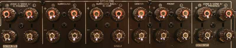

Of particular note, check out the number of HDMI inputs. With 1 on the front, that makes 8 inputs and 2 outputs. Since the RX-A3000 features HDMI-to-HDMI and analogue to HDMI upconversion, you're going to be able to grab any legacy devices you have lying around (like the antiquated 480i Wii sitting on your AV shelf over there) and run it up to 1080p output over HDMI. This is an AV receiver that's going to be able to walk with whatever you've got and put it up in the screen. But keep looking, there's more. If you're into whole house audio, the Yamaha RX-A3000 has four Zones for you to utilize. With 2 Zones that support an on-screen GUI (composite or Component) and a fourth Zone that can send optical TOSlink audio to a secondary AV receiver or integrated amplifier, the Yamaha RX-A3000 has enough juice to cover all but the most extravagant homes with plenty of audio. And, unlike most AV receivers, the Yamaha can finally utilize external amplifiers to deliver up to 11.2 channels of audio, even if you're crazy enough to utilize both front and back Presence channels in your home theater. Check out how they laid out the 11 pairs of speaker binding posts:
You can hit up the system to drive 7 to 11 channels in one room, or automatically wire it up to switch to 5.1 and power a second or even third Zone with the push of a button. But wait until we get to the menu system and you see all of the configuration options Yamaha has in store.

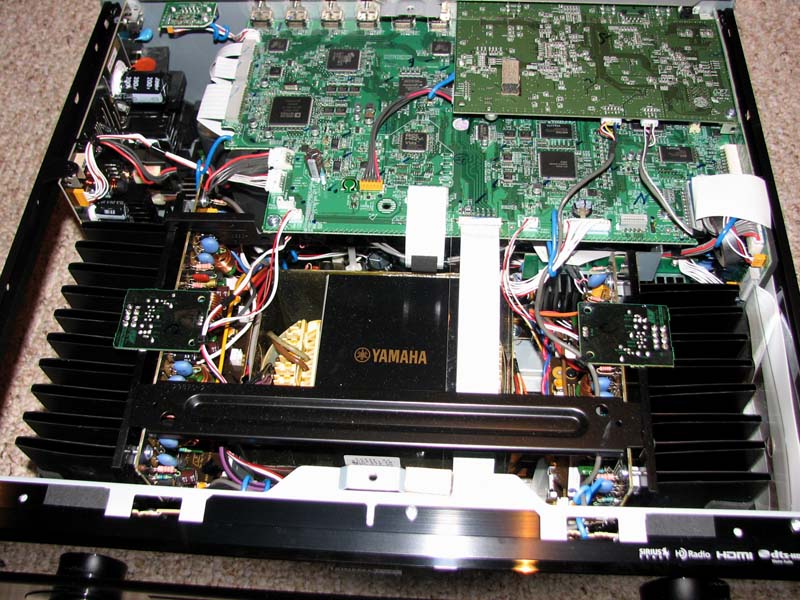

Yamaha truly lives up to their mantra of better build quality with their Aventage lineup of receivers.  Pulling the top cover off the RX-A3000 revealed no wasted space and meticulous attention to detail for reducing mechanical vibrations in the product such as felt taped heatsinks, padding for every contact point to the top cover, and their alleged 5th foot mounted directly under the centralized E-Core power transformer. At first this appeared to be a marketing gimmick, but there is method to their madness as it's not a lofty design goal to eliminate mechanical vibrations in a product, especially a transformer that likes to hum.  Unlike the RX-Z7's single heatsink for its power devices, the RX-A3000 splits this duty off to smaller dual heatsinks mounted on each side of the power transformer in what Yamaha calls dual symmetric power amplifier layout.  At first glance, these heatsinks appear small but more careful observation reveals extra thick metal plating at the base of the heatsink mounted to a very thick bottom cover to help dissipate heat and increase chassis rigidity.  Yamaha also employed brand new thermal control regulated power transistors in this baby to better manage heat.  It was clear to us that Yamaha proved their masterful craftsmanship with the execution of this compact, well engineered A/V receiver.
