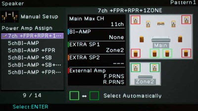

Assignable Power Amp
Channel Expandability w/ Ext. Amp (Up to 11.2)

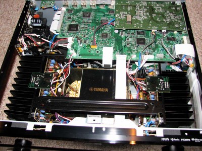

ichigo;847078
Actually it was pretty easy to see the capacitors, I took a look inside. 2 x 12,000uf, 2x 6,800uf, so 37,600uf total.
12,000uf caps seem pretty popular these days; I saw them in some Denons. I think pretty much everyone is just getting their stuff sourced from the same places these days.
The 6,800uF caps are not part of the power supply for the amp section. The 2 x 12,000uF caps are for the amp section.
ichigo posts on December 09, 2011 22:18

gene posts on November 14, 2011 15:43
Why is the actual size of the capacitor caps not noted? I notice for all the other flagship receiver reviews, the size in microfarads is noted...Conspicuously absent in this review.
Perhaps it's significantly smaller than expected and thus worth not mentioning...
Or perhaps the caps were not easily readable b/c they were tightly packed into the receiver so we didn't comment. I would make an educated guess based on performance than this receiver has a very similar power structure to the RX-Z7 I reviewed which had 2 x 18,000uF 71V caps.
