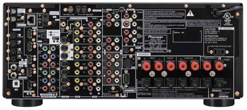

Back Panel of the Pioneer VSX-94TXH 7.1 Home Theater Receiver
I know I began with the software, but you'll also need to make sure your rear-panel connections are made correctly as well. I tend to start in no particular order, however if you're strapped for space you may want to work from the bottom up, or from one side to the other. The layout of the rear panel is about 80% organized with some odd hang-outs here and there like the Zone 2 and Monitor outputs. It would certainly look a lot better if Pioneer dumped about half of the S-video and composite inputs - which should go completely unused in 99.9% of homes. Four HDMI inputs should be plenty for all but the most techno-savvy users, though a second HDMI output would have put this receiver over the top.
The biggest drawback of the VSX-94TXH is the lack of dedicated Zone 2 speaker connections. While the amplifiers of the receiver are assignable for use as B-speakers, Bi-amping the main speakers, Surround Back or Zone 2, you'll actually need to pick one use and stick to it. To switch between Zone 2 and Surround Back, for example, would entail switching cables. We've seen other manufacturers handle this better with additional dedicated 5-way binding posts.
Audio connections seem plentiful, with lots of digital audio connections and, of course, the four HDMI 1.3a inputs which can each handle uncompressed PCM audio and bitstreamed HD audio formats. The VSX-94TXH supports both 7.1 preamplifier outputs as well as 7.1 multi-channel inputs, so it is virtually future-proof - at least until 10.2 becomes the defacto standard!

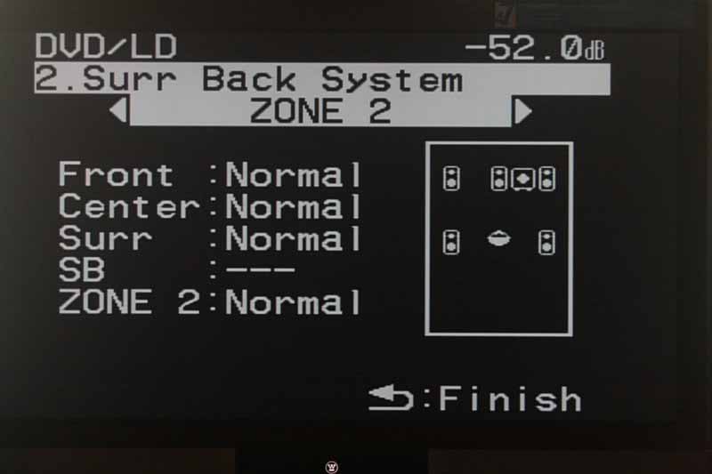

Setting Up the Receiver – Multi-Room Use
For multi-zone use, we'd only recommend the Pioneer VSX-94THX if you intend to either use an external amplifier, the digital Zone 3 output, or you have a 5.1 primary theater room. Because there are no dedicated Zone2/3 speaker connections, running a powered Zone 2 alongside a 7.1 system simply isn't practical. Zone 2 can be either powered (using the Surround Back speaker connections), line level (using the Zone 2 stereo analogue audio connections) and can support video output via a composite monitor output. Another drawback to Pioneer's multi-zone implementation is that Zone 2 audio will be interrupted any time the main zone audio is changed to a new source.
surround-back-system.jpgAs we mentioned, Zone 3 on the Pioneer consists of the ability to send a digital TOSlink connection to another room (no video). This means that you can fire over any digital source to another AV receiver located in your Zone 3 area. We tested this and found that Zone 3 works with Dolby Digital 5.1 surround sources as well as stereo PCM. Remember, however, that since the Pioneer only has a single XM and AM/FM tuner you won't be able to use these sources independently in more than one zone. Tune to a new FM station in the Main zone and your Zone 2 will change as well if it shares that source. A quick explanation of the possible modes for the 2 amplifiers that are defaulted to the Surround Back speakers:

  • Surround Back System (Zone 2)
    Here is where you can use the Surround Back amplifiers to power a set of remote speakers in a second Zone. This is very different from the Speaker B mode in that Zone 2 can receive its own discrete source and has the ability to use a composite video monitor output.
