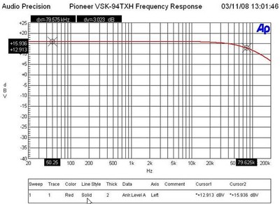

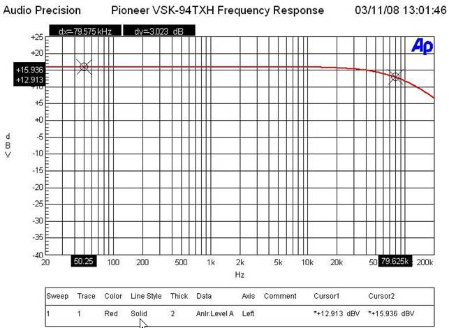

Frequency Response
Pioneer VSX-94TXH Frequency Response
The -3dB point for the VSX-94TXH was around 80kHz which is plenty of bandwidth for high resolution audio.

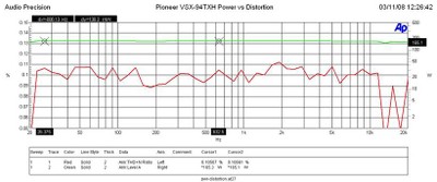

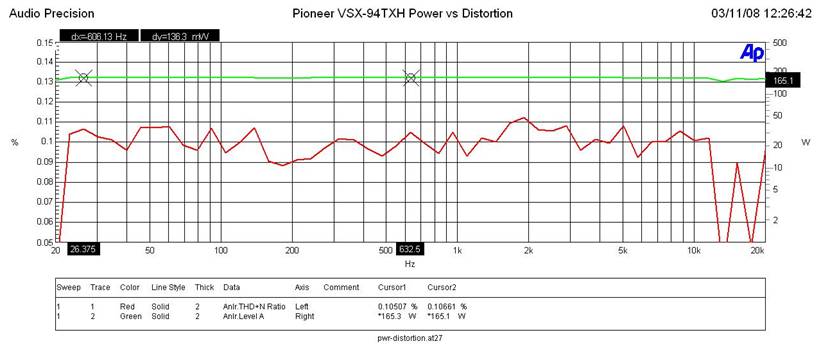

Pioneer VSX-94TXH Power vs Distortion
I measured continuous power vs distortion by setting up a regulated sweep in my Audio Precision to automatically adjust input level until the maximum power output is achieved at < 0.1% THD + N. The VSX-94TXH was plugged directly into an APC S-15 Power Conditioner with regulation to ensure the line never dropped below 118Vrms.
Power output: <0.1% THD + N for Pioneer VSX-94TXH
  • 165wpc x 1;   8 ohms
  • 155wpc x 2 ;  8 ohms
  • 270wpc x 1 ;  4 ohms
  • 225wpc x 2 ;  4 ohms

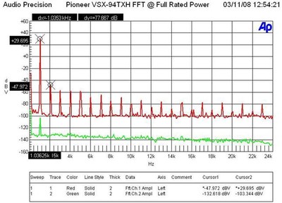

FFT Distortion Analysis
Pioneer VSX-94TXH FFT Distortion Analysis at Full Rated Power
At near full rated power (116wpc, 8 ohms) the VSX-94TXH exhibited average distortion measurements (29.695+47.972)dBv = 77.7dBv or 100*alog^-1(-77.7/20) = .013% THD + N. These results were a tad worse than I measured on the Marantz SR7002 and not nearly as good as I’ve seen on similarly priced units from Yamaha and Denon.

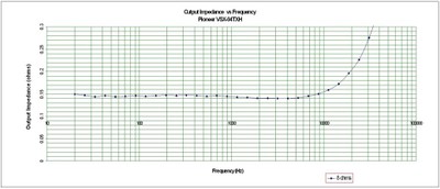

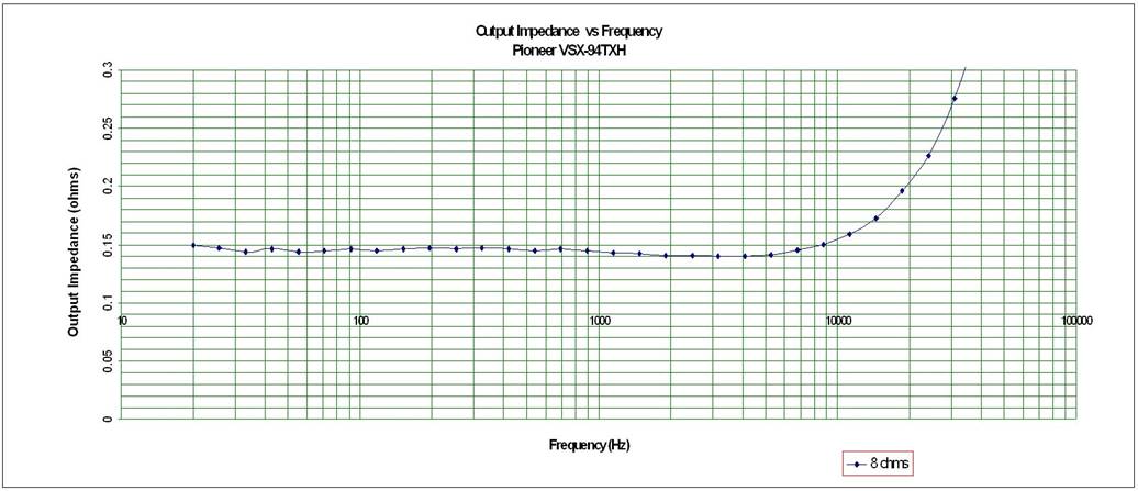

Output Impedance vs Frequency
Pioneer VSX-94TXH Output Impedance vs Frequency
The VSX-94TXH exhibited decent but not stellar output impedance maintaining around 150mohms for the audible frequency range of 20Hz to 20kHz when driving 8 ohm loads. This was considerably higher than the 100mohms I measured on the Marantz SR7002 and the under 100mohm measurements I pulled on the Yamaha RX-V2700. While this is still a much better measurement than you’d get with a tube amp, the VSX-94TXH has the potential to sound more “different” when driving a variety of low impedance speaker loads compared to the other receivers mentioned here.

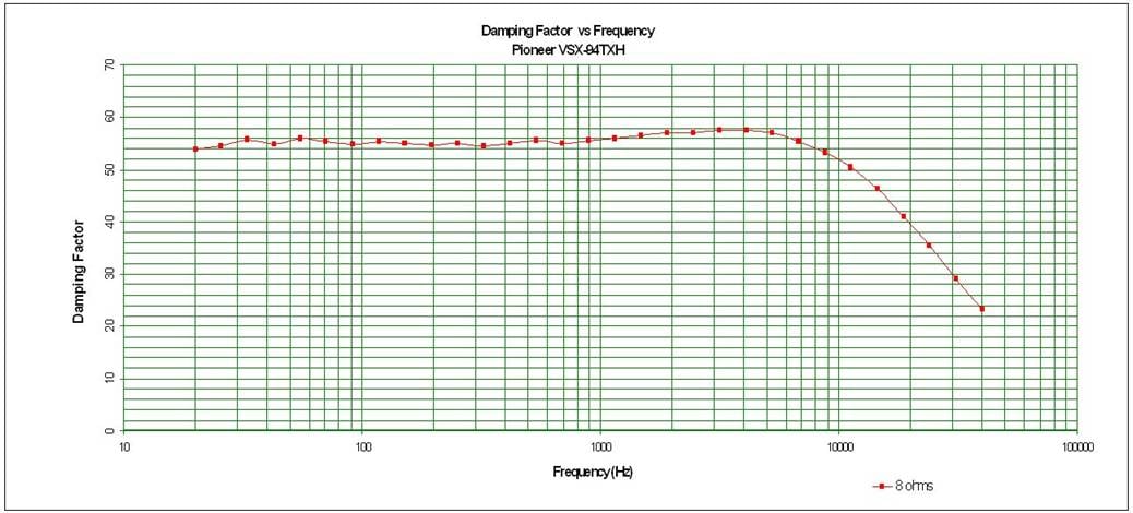

Pioneer VSX-94TXH Damping Factor vs Frequency
The VSX-94TXH, displayed a good damping factor commensurate with the output impedance the amp section exhibited. It just maintained the minimum 50 rating that we like to see when driving an 8 ohm load.
