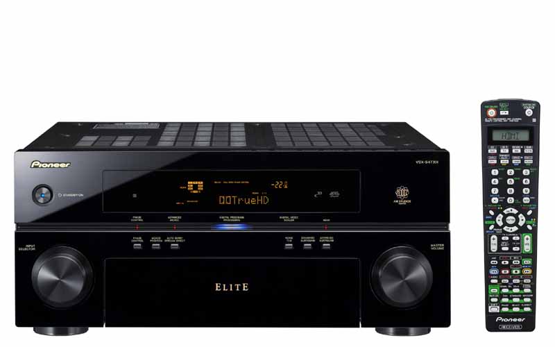

Pioneer's flagship AV receiver
(we're not counting the delayed-but-impending SC-09TX which debuted at the 2007
CEDIA) is simply beautiful. The receiver has a piano gloss finish and, unlike
the competition, places the annoying requisite technology logos across the top
edge of the receiver instead of the front panel. This leaves the receiver clean
and beautiful - definitely a visual step-up from other designs we've seen. Like
most receivers, the input selection knob is on the left and the
heavily-weighted master volume is located on the right. The detents on the
input selector are solid and I really liked the way both knobs felt when
turned. The Master Volume only increases in 1dB increments, however I don't see
this as an issue for most users. With the front panel door closed, there are only
six buttons present in addition to the Standby/on function. There is no hard
Power Off switch on the Pioneer; you'd need to unplug it to take it out of
Standby mode.

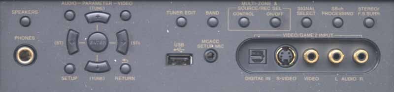

The clean front panel opens smoothly to grant users access to various features such as the Video/Game 2 input and menu controls. You can also control some tuner functions, connect headphones and a USB storage device, and of course the MCACC microphone. Multi-Zones can be activated and deactivated here and you can control the Signal type for each input (important for insuring you route the correct audio to the selected source.)

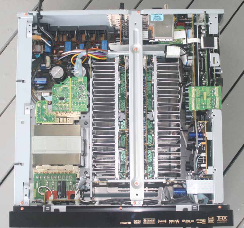

Cracking
open Pioneer's flagship receiver I immediately noticed the gigantic EI Core
transformer that dominated the side of the unit, joined by a couple of 15,000
uF capacitors. The power supply is clearly large enough to drive the amplifier
section of the receiver to its rated specifications. Once I made it past the
robust power supply, I couldn't help but be drawn to the two rather
cheap-looking and thin aluminum heatsinks that ran down the center of the
receiver. While it appeared to do the job, it certainly didn't look like
something I expected to see on a flagship product. Typically, you will see a
thicker aluminum heatsink like that
which I just witnessed on another manufacturer's receiver I reviewed this past
week which costs about $400 less than the VSX-94TXH. This isn't a big deal, but
flagship products like this command a particular aesthetic from users that
needs to be met.
