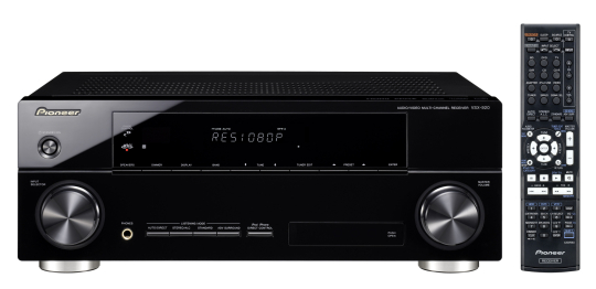

VSX-920-K_FRONTPioneer Electronics' new line of receivers continues to impress with their feature for price ratio. So far we've previewed the VSX-520-K and VSX-820-K. These retail for $229 and $299 respectively. The differences between the two are pretty significant and many might be able to justify the additional expenditure for the 820. The question is whether those same people might be convinced that spending an extra $100 for the VSX-920-K will be worth it. Maybe not if they are extremely tight of wallet but we're betting that a few looking to spend sub $500 will take a hard look at the $399 VSX-920-K.
Check out AV Rant for an interview with Dave Bales of Pioneer Electronics about their new line of receivers.
All of Pioneer's new Pioneer-branded receivers are rated at 110 watts per channel and the VSX-920-K is no different. One of the major steps up in performance for the 920-K is that they are bumping up from five internal amps to seven. While you needed a pre-out to employ surround back speakers, with the VSX-920-K you can use the internal amps. Like the rest of the new line, Dolby ProLogic IIz is on board but now you can assign the surround back amps to these height channels.

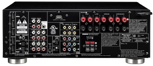

VSX-920-K_REAR
The input and output configuration of the VSX-920-K is pretty much identical to the VSX-820-K so we won't go over it again. Other than the two additional channels of amplfication, the back panels look identical. You have four HDMI inputs and one out, two component inputs and one out, and a slew of composite video and analogue stereo inputs. One thing that is missing (actually replaced with different outputs) are the left/right analogue pre-outs used for the surround back/height channels on the VSX-520/820-K receivers. Those pre-outs have been replaced with a generic stereo output. This means that you can't run a full 7.1 system AND height channels (you have to use the internal amps). Not really a deal-breaker but something to consider.
