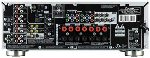

To passively bi-amp your Pioneer VSX-815, simply follow these steps:
  • Remove the jumpers that join the "hi" and "low" binding post inputs on your main speakers
  • Connect the Front Left & Front Right outputs to the "high" binding post inputs of each of the respective loudspeakers
  • Connect the Surround Back speaker outputs to the "low" binding post inputs of each of the respective loudspeakers
  • Se the SB.SYSTEM setting to "BIAMP"
