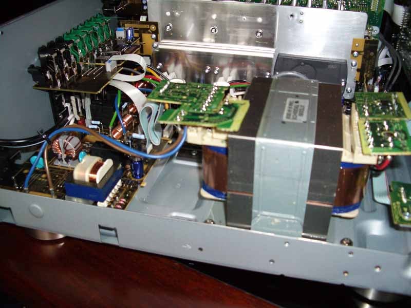

PioneerVSX815PS_lg.jpgThe VSX-815 is of average build quality for a receiver at this price point. While it states 7 x 100 watts output, that is obviously not an "all channels driven" rating (nor is it implied in the specs) and based on the power supply and information we could glean from the components, you can expect to have no trouble powering a set of 8-ohm moderately efficient speakers in an average sized living room with this receiver.
A respectable power transformer and a pair of 4700uF capacitors make up the major components of the power supply. Heat is dispersed through the use of an aluminum radiator well-positioned over air intake vents. A fan is also present just beyond the heat sink fins though I never actually heard it turn on during or just after my listening sessions. The overall layout seems to be organized and efficient. I noticed no apparent issues in terms of grounding or interference and the engineering that went into this product seemed to be very well thought-out.
