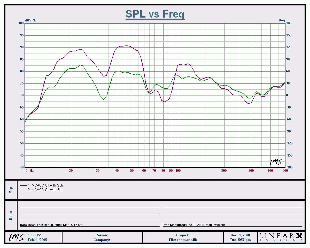

As I found with other room correction systems, the end results were a mixed bag. MCACC correctly identified distances of all my speakers, including the subwoofer which only Audyssey has consistently done in my setups in the past. It was also pretty spot-on with level at least for the 5 main channels. The subwoofer was overly boosted which oddly wasn't the case when MCACC was engaged. It incorrectly set my rear bookshelf speakers to Large so I went in and adjusted them to Small.

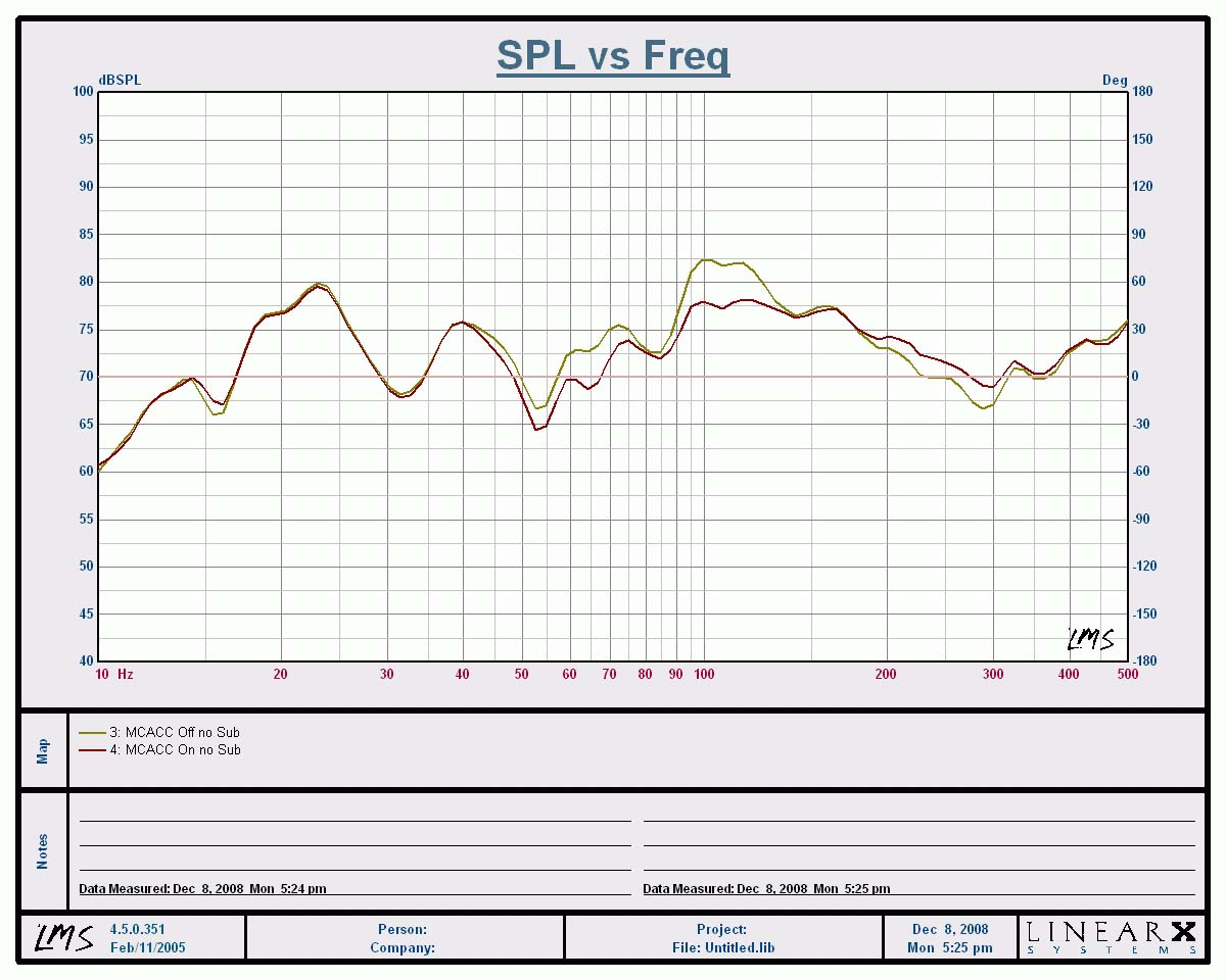

                                  bass-sub   bass-nosub
MCACC On/Off Mains + Sub (left) Mains Only (right) 1/12th Octave Frequency Response
Configuration Note: The Sub was set to "plus" so it would output bass to the subwoofer with the mains set to "Large" for 2-channel sources.
Upon first listen of my post-MCACC calibration, I noted the overpowering bass as soon as I switched off the MCACC. At first glance I thought it was actually doing an excellent job of balancing out the system's bass response and reducing room modes. That was until I pulled a couple of measurements to understand what was really going on. The left graph above shows the frequency response differences of the main channels with the sub in the main seated position with MCACC on (green trace) and off (purple trace). The shape of the curves are virtually identical except the MCACC curve was 10dB lower below 60Hz. MCACC did seem to smooth out and raise a null between 60-90Hz a bit as well. I decided to switch off the subwoofer and re-test for just the main channels (above right graph) to get a closer look. This time the curves were virtually identical with MCACC slightly reducing 60-90Hz and 100-150Hz. It seems MCACC was marginally fixing the bass response, but more importantly, it was honing in on the correct level to better blend the mains with the subwoofer. I am sure with manual intervention, and tweaking, I could have probably improved upon this further.

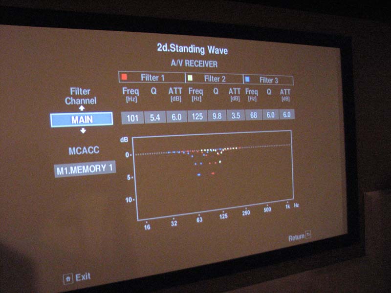

MCACC Standing Wave Correction
The Standing Wave Correction plot provided in the MCACC setup does show some of the problem areas at my listening seat that it was attempting to flatten out, namely the 63Hz and 125Hz regions. With manual tweaking, this could be a very useful tool for smoothing out bass response.

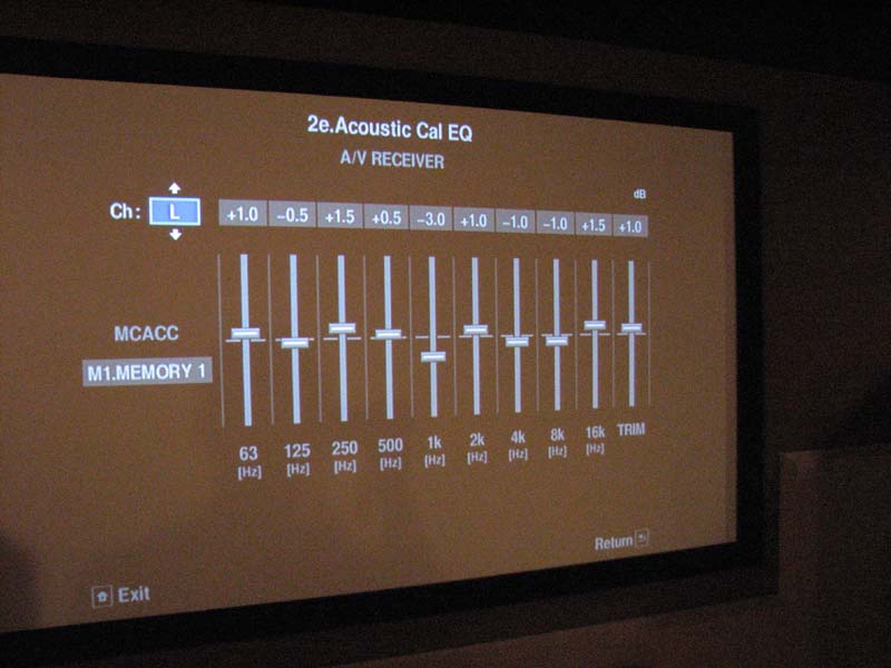

sc07acouticcal.jpgThe graphical readout of MCACC calibration results was a welcomed feature and useful for understanding to what extent correction has been made. As you can see in the results of the calibration to my front speakers, very little EQ'ing was performed by MCACC, a tribute to well-designed reference speakers in an acoustically controlled listening space.
I did some spot listening tests and found MCACC offered mixed results in my setup - no different than any other room correction system I have worked with. With it engaged, it seemed to anchor the vocals at the expense of collapsing the width and depth of the soundstage. This was most notable in two-channel sources. I did prefer the more natural and tighter bass MCACC offered but I could achieve most of this by simply lowering the sub an additional 8-10dB. Most of my listening tests were conducted with MCACC Off as I ultimately preferred it that way after extensive two-channel comparisons.

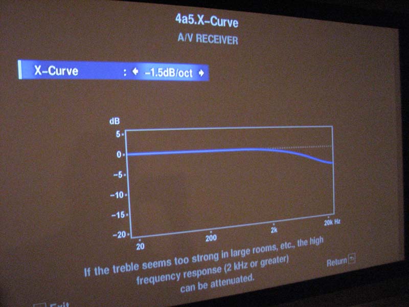

xcurve.jpgIn closing, MCACC is a useful tool that should, at the very minimum, be used for proper speaker distance and level setting. Personally I would like to see Pioneer offer a better quality microphone on near-flagship models such as the SC-07. An omnidirectional mic with a long nose and not a flat flimsy hockey puck included with this receiver would likely yield more accurate calibration results. More advanced users would be wise to tap into some of the more advanced settings for tonal adjustments as needed. I particularly really enjoyed the X-Curve feature that allows you to adjust roll off from 2kHz to 20kHz at a slope between -0.5dB to – 3dB. This is a useful tool for DVD mixes that are too bright that you may wish to tame to reduce listening fatigue.

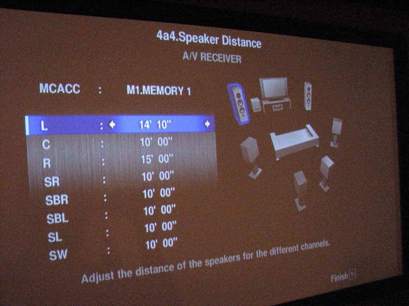

speaker distance.jpgAs with most modern A/V receivers and processors, the Pioneer SC-07 comes with an array of speaker configuration options. The SC-07 was a bit limited in crossover options with the following increments: 50, 80, 100, 150, 200Hz. Personally I'd like to see 60Hz thrown in there as well but 80Hz will work just fine for the majority of setups. I was pleased to see Pioneer offer a "+10dB bass boost" via the External multi-channel inputs. To my knowledge Denon was the only one offering this type of feature and more companies should pay attention and follow suit.
Editorial Note: Reason for Optional Bass Boost via External Multi-channel Analog Inputs:
The suibwoofer channel in Blu-ray discs is encoded 10 db lower than the other channels. If the codecs are decoded by the receiver, the LFE automatically boosts 10 db to compensate for this. If the codec is decoded in a Blu-ray player and then sent via analog cables to the receiver, it is not boosted by the player. Most players have no method of raising the LFE to a level to match the other channels.
Channel trim adjustments were offered in 0.5dB increments and delay adjustment precision was within 1-inch increments which is a rare but welcomed precision offering. The crossovers worked as expected for a THX Ultra2 certified receiver as indicated by the 12dB/oct High Pass Filter (HPF) slopes on speakers set small and 24dB/oct Low Pass Filter (LPF) slopes on the subwoofer output which I measured with my Audio Precision SYS 2722 Audio Analyzer.

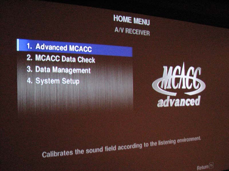

sc07 home menu.jpgAs previously mentioned, the SC-07 sports Faroudja DCDi video processing for deinterlacing and scaling of incoming analog video signals to HDMI. It wasn't clear in the manual if the SC-07 supports 1080p analog video so I tested it with my Xbox 360 via component video at 1080p resolution and was unable to get a picture via HDMI until I lowered the resolution to 1080i. Thus I would take that as a "no" for 1080p analog video upconversion. As far as I know the video processing for this receiver is only applicable for analog video sources which is a limitation some of Pioneer's competitors (whom have more advanced video processing) doesn't share. In fact, had I not opened the manual, I would have never known this receiver had video processing for analog video sources since these options weren't available on the main OSD page and would only show up if you hit "Video Parameter" on the remote when playing an analog video source. Once you access this page, you can adjust Brightness, Contrast, Hue, Chroma and Resolution.
Unfortunately the OSD doesn't overlay over the video signal like some of Pioneer's competitors. To make matters worse, when you enter the OSD, it kills the audio signal until you exit. This was acceptable 2 years ago, but Pioneer seems to have fallen a bit behind here. Overall, the OSD was basic and easy to navigate through except for the video processing issue I previously mentioned.

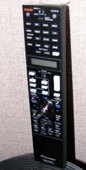

remoteI didn't get too involved with the remote control Pioneer supplied with this receiver. It is similarly bad to other brands I've tested with receivers in that it has limited backlighting and a cluttered faceplate with too many button options - most of which are useless in the dark. I was a bit perplexed as to why I couldn't access all of the receiver setup options via the "home menu" button and had to also use two additional buttons "audio parameter" and "video parameter" to make additional adjustments and configurations. Lose the remote, and you lose the ability to make these adjustments.
Pioneer does not include a multi-zone remote which is surprising to me as I find that to be a useful feature for basic multi-zone control from another room if the receiver is line of sight.
