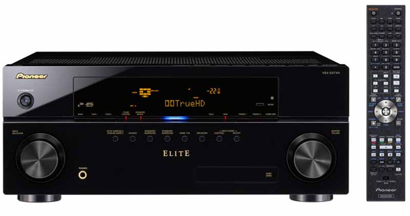

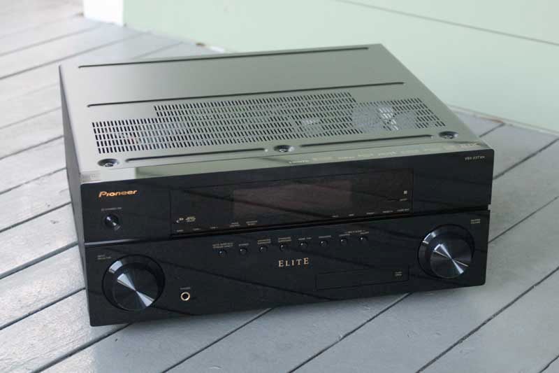

front remotePioneer makes a very beautiful A/V receiver. The front sports a piano gloss black finish and there are blue accent lights below the display panel and which indicate powered-on status. Thankfully, and unlike most of their competition, Pioneer also places the dozen annoying requisite technology logos on the top of the receiver instead of decorating the front like a tattooed prison inmate. Controls are pretty standard on the front with the input selection knob is on the left and the rugged-feeling volume control on the right. Unlike the last Pioneer receiver I reviewed, the Master Volume increases in 0.5dB increments, suitable for even the most discerning users.
As with prior models, the front has a small panel that opens to allow access to some front inputs. This time, Pioneer includes an HDMI 4 input (for modern digital video cameras), iPod (via mini connector and USB control), and the MCACC setup microphone input. This front HDMI input is a duplicate of the #4 HDMI on the rear of the receiver, not a true fifth input. When you plug into the front input, the rear HDMI input is defeated. The remaining real estate on the front is devoted to radio tuning controls, surround modes, speaker selection, multi-zone controls and status indicators. The orange front display is jam-packed with information, showing the input audio format (analog/digital/HDMI/PCM) and channel info, volume levels, tuner info, source, and even the precise audio decoding format.
In the course of examining the top logos, we noticed a new icon that corresponded to a rebranded feature called Phase Control (formerly called "Full Band Phase Control"). Phase Control is a feature that, best as we can tell, uses phase correction (group delay) to help ensure that both high and low frequency information is properly aligned at the point of transmission. What we don't understand, however, is how this feature deals with the obvious group delay and phase-affecting conditions that plague most listening rooms, such as the position of the speakers, location of the subwoofer and room acoustics. All of these effects occur in the analogue domain, well after the AV receiver does anything to the signal. Pioneer strongly recommends this feature be left on (which is the default) and we couldn't hear any deleterious effects when it was engaged, so we won't buck their system.

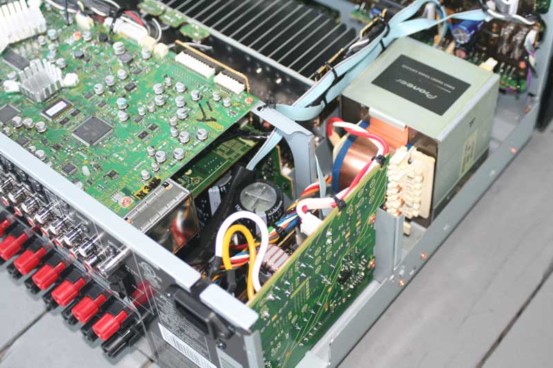

insidesWe popped open the VSX-23TXH and noted the large EI Core transformer and dual 15,000 uF capacitors. The power supply is ample enough to take it to its rated specs and power all but the most inefficient of speakers to near-perfection. Pioneer continues to use the flimsy, but sufficient thin aluminum heatsinks that are positioned across the central area of the receiver. The manufacturer did an excellent job of packing everything into a relatively tight space, and we could see that the front display panel and video features were well separated and shielded from the power supply.
