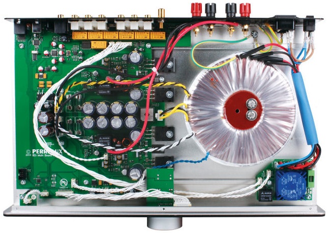

The Audiant 80i sports 80 watts x two into 8 ohms. It has a class A/B amplifier with a massive high-current toroidal power supply (check it out below). If you had any doubts about the power supply, just pick it up. At 25.3 pounds, it's no lightweight (remember, it's just two channels - no frills). There is a phono input for the vinyl lovers out there (and integrated amp people tend to have at least some vinyl) and preamp outputs for using your own amplifer if the internal amps aren't cutting it for you. The front is clean with a single knob for volume - and a remote control for everything else.

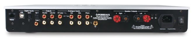

back
Now for the new. The front has a number of LED backlit controls that utilize capacitive touch technology just like many of the iProducts giving the Audiant 80i a very high-tech feel. The backlighting of the touch panel can be dimmed to suit your particular needs (nothing is worse than one of those bright blue lights that distracts from your movie/music experience). There is a "home theater" input which looks to be a pair of RCA inputs. It's a little unclear as to how these work but the USB input on the back is definitely unexpected in an integrated amp. With it, you can connect directly to a computer and the IR remote can be used to control both iTunes and Windows Media Player.
Audiant_80i_insideUpsampling is important for Perreaux and the Audiant 80i will upsample everything to 24-bit/96kHz including the audio over USB, the two optical, single coaxial digital, and two additional analogue RCA (aside from the home theater and Phono) inputs. There is a single RCA output on the back with an arrow pointed down. We're not sure if that is some sort of grounding solution or a subwoofer output (we're hoping for the later but we wouldn't be surprised if the Audiant 80i didn't have bass management).
The Perreaux Audiant 80i features MOSFET output devices, 1 watt power consumption on standby, and the coaxial digital input is transformer coupled, providing electrical isolation and improved jitter performance for coaxial digital source components. The binding posts are five-way and plastic (surprising) though they look to be of sufficient quality. The overall size of the Audiant is impressive. We mentioned that it weighed over 25 lbs but what is more notable is that it is only 2.6" tall. This is a very low profile for any home theater device outside of an old DVD or CD player.
