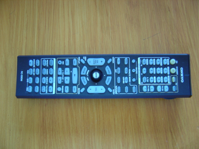

DSC02611.JPGThe remote control is a standard Onkyo design that has been in use at least since the TX-SRxx2 generation, it is identical to what I recall of my TX-SR602 remote. It has a fairly standard feature set typical of most A/V receiver remotes. In addition to the obvious, it has programmable universal remote capability via a host of remote codes for various manufacturers and supports three programmable macros.

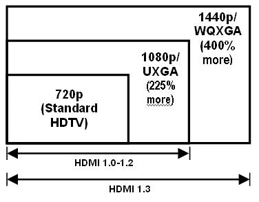

As with audio, the TX-SR805 supports many of the latest video features and enhancements available through HDMI 1.3 and above such as Deep Color. Currently, digital video is encoded with 8 bits of data for each of the primary colors, red green, and blue in an RGB color space. The combined 24 bit color representation produces over 16.8 million color variations, which commonly is known as Truecolor. Many current DVD players specify a 10 bit video processor, which can be confusing as the color, is still represented as 8 bits in video encoding, while the extra 2 bits in the 10 bit processor amounts to digital headroom. Deep Color extends the color depth to true 10, 12, or 16 bits of data for a total of 30, 36, and 48 bit color representation. As this total color depth gets beyond the human eye’s ability to resolve distinct colors, the main advantage is that it will reduce posterization, which is the visible banding in an area of continuously varying color when not enough different colors are available for accurate representation.
Buying hardware that supports Deep Color is future proofing and the TX-SR805 supports up to 12 bit per color (36 bit RGB) Deep Color. When researching products, take care to look for specific features and functionality, because HDMI profiles are flexible not every product that states version HDMI 1.3 or greater is or has to be Deep Color capable. Any piece of equipment in the A/V chain that does not support the higher bit depth will limit the system to 8 bit performance, so choose wisely. The TX-SR805 may not provide another redundant scalar to 1080p resolution, but it will not choke it off the signal quality as it passes it along.
