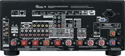

Taking a look at the back, we see the other seven HDMI inputs. We like that Onkyo has placed the 5-way binding posts in a line rather than stacked. This makes bare wire connections much easier (or possible) and even eases the use of other speaker wire termination types like banana plugs. To make switching speaker configuration easier, Onkyo has included outputs for up to 11 speakers (it can power three zones of audio - though not simultaneously). Other than HDMI, Onkyo has includes two component video inputs (one output) and four composite video (one output). There are seven pairs of RCA inputs for stereo audio as well as 9.2 outputs for integrating external amps (7.2 channels plus front channels) and line outs for Zones 2 and 3. In addition, there is a second USB port on the back, an Ethernet connection, three coaxial and two optical digital audio inputs, and a PC input. For $1000, the TX-NR717 has a ton of connectivity.

txnr818_rear
As you can see, the changes are minor. There is now an RS-232C port for custom installer control plus a removable power cord (it's actually quite unusual to find a hardwired cord at the TX-NR717's price point). Also, 12 volt triggers are included for controlling Zones 2 and 3 - another nice installer-friendly feature. Glancing at the front (picture on the top of this article), there is a flip down panel revealing a host of controls plus a full analogue inputs (composite video plus stereo RCA) and an additional optical input. Lastly, for installers and hard-core enthusiasts, Onkyo has included in the TX-NR818 a Dual Core Video Engine which offers video calibration to ISF standards for color correction at the receiver level (though we have no idea why you'd want this as opposed to doing it at the display). The TX-NR818 sports full 9.2 channel pre-outs (rather than the TX-NR717's 7.2 channels).
