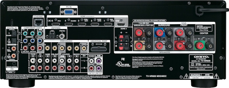

The Onkyo TX-NR609 features 7.2 channels with 5-way binding posts for the five of those and spring-type for the surround back channels. There are six HDMI (one on the front), 2 component video, one PC (RGB which will be converted to HDMI by the receiver), and four composite video inputs and one output for each. The HDMI ports are version 1.4 and support 3D video, HDMI Thru (in standby), and an Audio Return Channel. The TX-NR609 sports two each digital optical and coaxial audio inputs and six analogue audio inputs. Zone 2 audio is supported by pre-outs (as are the dual subwoofer outputs) or powered through the surround back channels but there are no other analogue inputs or outputs for integrating legacy gear or external amplification. What there is, however, is a rear Ethernet port and a front USB. The USB port offers a direct digital connection for an iPod or iPhone, along with support for audio playback from USB mass-storage devices. In the case of the TX-NR609 the USB port even support album from your iPod/iPhone.
