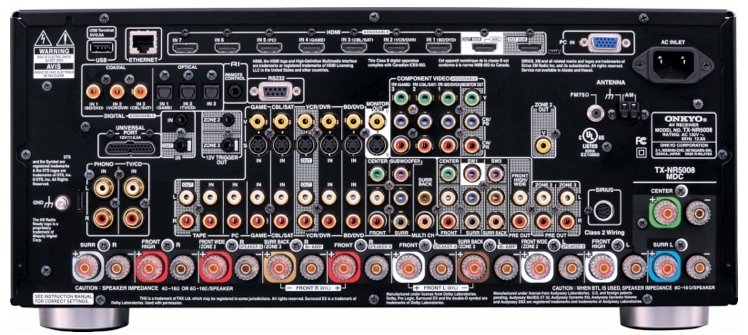

rear panel
As for analog, the TX-NR5008 has 7.1 channel input and a 9.2 channel preamp output for use with multi-channel analog sources or external amplification.  There are five standard analog A/V inputs that include composite and S-video connections, one front and four rear connections, a 15-pin D-sub PC video connection, a VCR A/V out, video out to a monitor, and audio in from a monitor.  The zone 2/3 connectivity options include separate zone 2/3 preamp outputs for when amplifier channels are not reassigned and a zone 2 video output.  There is even an audio input for connection to a turntable, although the turntable input may require a phono preamp, depending on the cartridge type.
