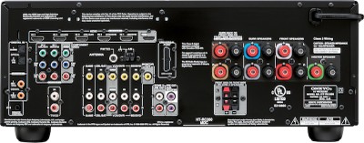

htrc260_rear
The Onkyo HT-RC260 has Audyssey 2EQ (which is a step down from the offering in the HT-RC270) though it maintains the Audyssey Dynamic EQ and Volume features as well as the height channels from Dolby ProLogic IIz. It features all the latest processing including Dolby TrueHD and DTS HD Master Audio. It doesn't have the THX certification of the 270 so you won't have access to any of the THX specific modes but then again, the certification price hasn't been tacked on to the receiver either.
The "Universal" port is still available as are two component video and two coaxial digital audio inputs. There are two optical digital audio inputs (one less than the 270). Most notably lacking are the 7.1 channel analogue inputs for integrating legacy gear or 7.2 channel outputs for adding and amp. The HT-RC260 does have analogue outputs for Zone 2 as well as dual subwoofer outputs. Most notably lacking are the extra five-way binding posts that would make switching between Zone 2 and one of the height/width channels that Dolby PLIIz/Audyssey DSX provides. Instead, you have five-way binding posts for seven channels with two pairs of spring-type binding posts for switching. Not nearly as convenient as the bigger brother's 11 pairs of five-way binding posts.
For $500 (a full $350 less than the HT-RC270), the Onkyo HT-RC260 packs in a lot of features. What are you missing are a few speaker connection points to make switching configurations easier, an input or two, analogue pre-ins and pre-outs, THX certification, and all of the network features. What you get is virtually the same amp section, Faroudja DCDI Cinema video processing, a ton of HDMI 1.4a inputs, dual subwoofer outputs, and all the latest audio processing. If you aren't that interested in networking and streaming, you can save a cool $350 by going with the HT-RC260 over the 270. Hey, that's like two pairs of shutter glasses and a 3D Blu-ray player! For some that is money well saved.
