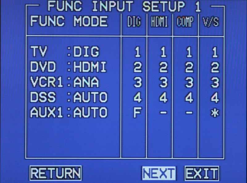

Input Setup
SR7002-input-set-audio.jpgHere you'll be able to adjust how audio will be received for the 8 primary inputs. You can select from HDMI, digital (DIG), analogue (ANA), or AUTO. AUTO will sense the active digital connection. If no digital input is detected for that input, the analogue input will be used. Once you set the type, you can assign the number of the input using the grid shown. This is a perfectly easy way to navigate the input assignments and the OSD automatically prevents you from assigning any input to more than one source.
The 7.1 multi-channel input gives you the ability to adjust the level of each channel from -12dB to +12dB. The video assigned to this input can be assigned by the OSD or set to LAST which maintains the last used video input before the 7.1 inputs were selected.
The last thing you can do with the Input menu is rename each of the inputs as you see fit. This is a handy feature, but remember that you cannot rename the buttons on the remote control - so choose wisely. The names can be upper or lowercase and all of the primary symbols are available for use as well.
