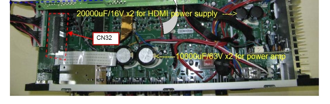

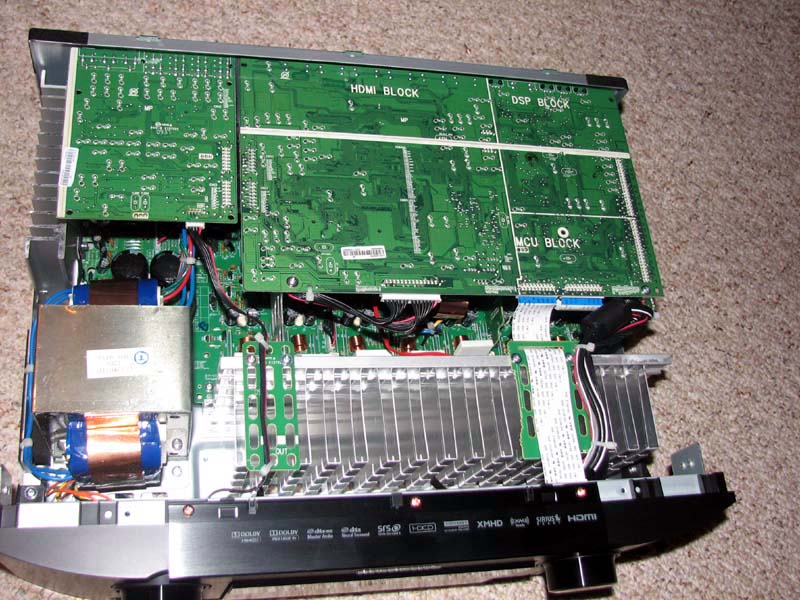

SR6004-no-coverThe SR6004 is what I call a midsized receiver.  It doesn't take a forklift to move, yet it has a solid feel to it which implies a decent sized power supply to amply drive a full 5.1 or 7.1 speaker configuration.  The SR6004 employs a class A/B power amplifier design and is rated for 110wpc x 7.  I always pop the top off of any receiver I review prior to hooking it up as I like to know what's under the hood.  The EI core transformer appeared to be quite sizable for a receiver of this price class, but those power capacitors I saw near the transformer looked puny.  They were 20,000uF but only rated for 16V.  The minimum voltage caps that should be used to produce the rated 110wpc should be at least 50V.  At first glance I thought I found a major design error in this receiver until Marantz engineering pointed out that the actual power supply caps were hidden underneath the HDMI board and were in fact 10,000uf, 63V rated.
SR6004-Caps_hdmi
Marantz SR6004 Power Supply Capacitors

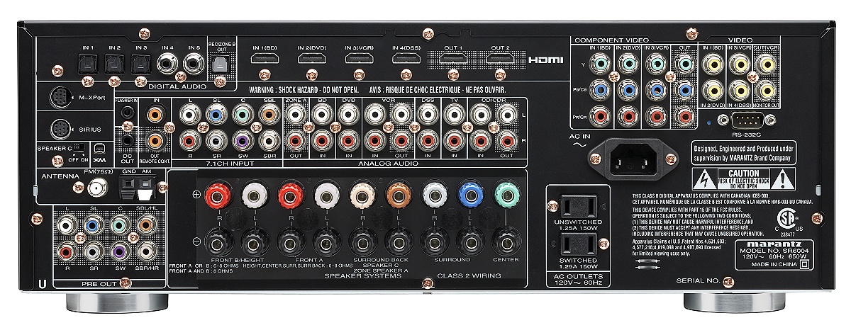

SR6004-back
Marantz SR6004 Back panel View
 The SR6004 back panel is laid out quite nicely.  It's not a cluster of connections like you find on many other receivers these days partly due to the absence of S-video connections.  There are binding post connections on all 9 pairs of speaker terminals, 4 HDMI inputs and dual HDMI outputs.  The SR6004 has a two-prong detachable power cord, one switched and one unswitched outlet and 7.1 preamp inputs and outputs to allow for future format expansion and external amplifier, respectively.

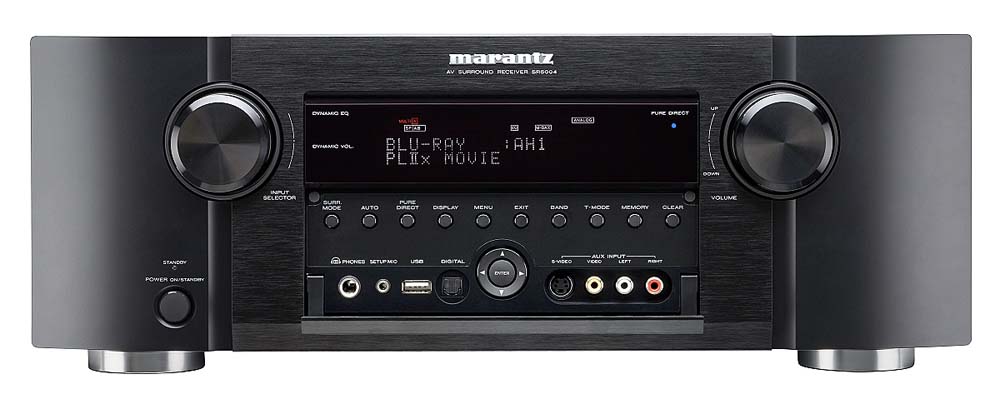

Marantz-frontcover
Marantz SR6004 Front panel View
 The SR6004 doesn't have the typical boxy feel you get with most receivers.  Instead it sports some sexy curves given it the feeling of a high end gear not dissimilar to their beautifully crafted two-channel reference gear.  The front panel has an array of buttons and inputs.  Oddly, there is an S-video connection which in my opinion would have been better to be an HDMI connector instead.  The front panel also includes a phono input, USB connector for use with flash drives, or music streaming devices such as an iPod, analog audio and composite video and Toslink for digital music sources.

gene posts on June 13, 2010 11:33
Marantz seems to have made some modifications to the heatsink, although it mostly looks like a typical Sherwood heatsink. If this receiver is made by Sherwood, it was definitely made to Marantz's exact specifications. That is a bold beautiful machine.
Heat sinks are pretty generic parts. The same heatsink is likely used on many different brands and model#s of A/V receivers. Marantz and Sherwood receivers are not shared platforms as far as I can see.
