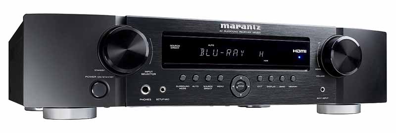

NR1501 angled beautyThe Main Menu contains five basic areas, including System Setup, Input Setup, Speaker Setup, Ch(annel) Level Setup and Sound Parameter. Before we did anything, though I suppose it was out of order, we ventured into the Speaker Setup menu and began to configure our surround system. Aside from the Auto Setup which uses the included calibration microphone and Marantz Room Acoustic Calibration (M.R.A.C.) system, there are 4 options: Speaker Config, Speaker Distance, Speaker Crossover, and Room EQ Setup.

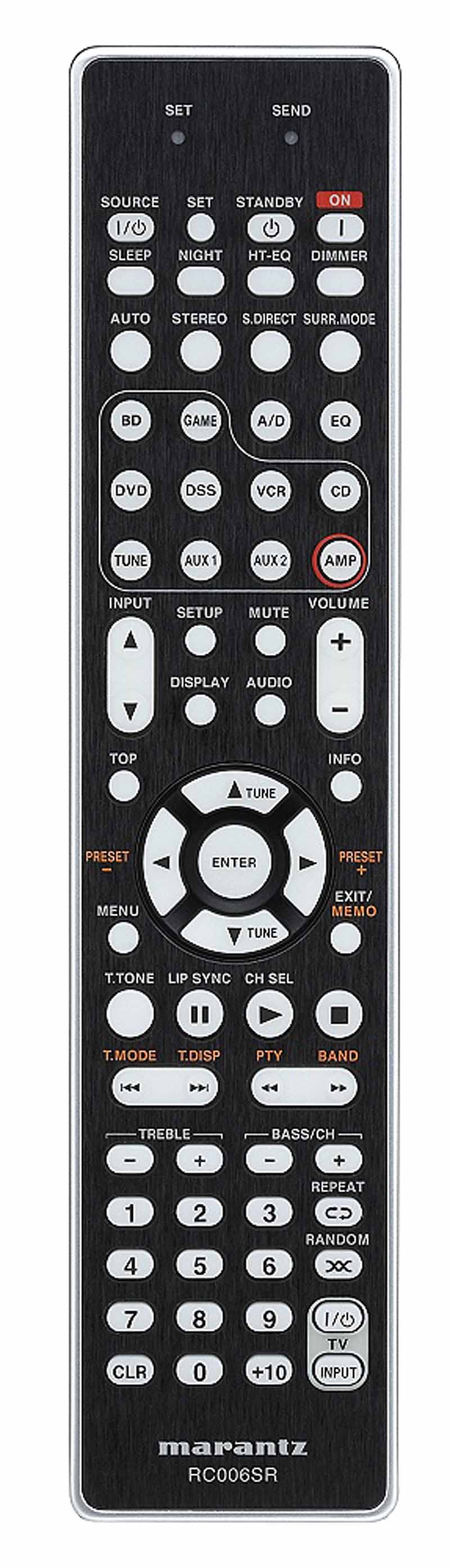

RC006SR Remote Control
NR1501 remote controlThe remote that comes with the Marantz NR1501 has what's known as glow keys, or as we call them lovingly around here – "I'm-too-cheap-to-have-backlit-keys" keys. It's a basic remote and if you can see what you're doing it will serve you well. In the dark, however, it's difficult to navigate since 70% of the keys are identical in size and shape. The topmost section is dedicated to power and global functions like LCD dimmer and Night mode. The next section controls the sources. In the middle lies the menu controls, with the navigational section just underneath. Finally the keypad and EQ controls make up the bottom as do the oddly-placed TV Power and Input buttons. The Setup menu is activated by selecting the Amp source and hitting the Menu button – this felt rather odd to us, since the button marked "Setup" doesn't seem to do anything (and was the natural place we tried first). You won't exactly break this remote over your knee in frustration, but replacing it with a good universal remote control will make the entire system run that much more smoothly.
