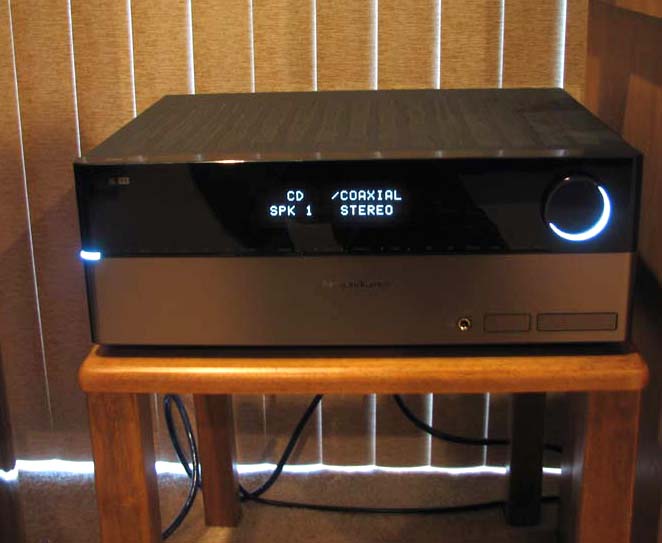

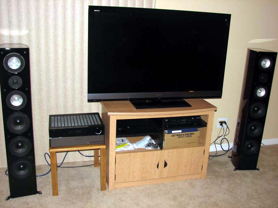

After bench testing the HK 3490, I hauled it over to my friend's house to set it up in his system.  His system consists of a pair of EMP E55ti towers, a cheap $30 Sony DVD player, Motorola Brighthouse cable box, Planet Waves analog interconnects, Cardas 11AWG speaker cable and Sonicwave toslink and coax cables.
I configured two of the inputs of the HK 3490 to receive digital audio signals from the Sony DVD player and the Motorola cable box.  Setting the inputs up to accommodate digital sources was a bit tricky as it wasn’t intuitive, and I eventually found it buried in the manual. To select the digital audio input, press and hold the front-panel Source Selector and simultaneously press the T-Mon Selector to change the audio input as follows: Analog, Optical, Coaxial.  Do this for each of the two inputs which in our case was for the "CD" input for the DVD player and "Vid 1" for the cable box.  It's important to note that the AKM DAC's of the HK 3490 only support two-channel PCM.  So, you need to configure your DVD player for two-channel PCM else you will get no audio via the digital connection if the player attempts to output a DD/DTS bitstream.

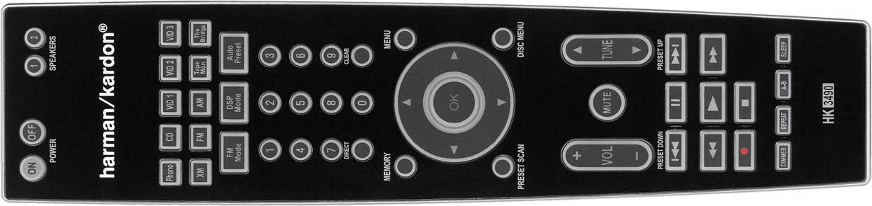

Remote Control
There is nothing fancy or unusual about the remote control of the HK 3490 other than perhaps its ginormic size.  It’s a completely push button remote that has no backlighting or learning functionality, but it can however operate other harman/kardon equipment.  I liked the fact that it has a speaker 1/2 selector to chose which speaker pairs are playing without having to make this choice on the front panel display like you often have to do with other products.  In systems utilizing multiple sources, we suggest investing in a budget universal remote from the likes of Philips, URC or Harmony and stow this one away for future reference.

I’ve always liked the sound of harman/kardon stereo receivers so I was excited to get the chance again to hear one of their latest creations first hand.    Unless otherwise stated, all listening tests were conducted full range with no powered subwoofer and with the tone controls set in their Zero default position.
