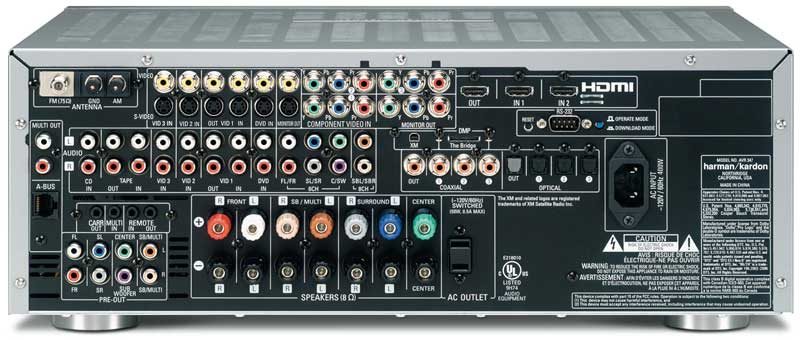

The AVR-347 is practically stuffed with inputs and outputs. There are three component video inputs and two Simplay HD-verified HDMI inputs. In addition to the superfluous S-video and composite video inputs, the receiver is also equipped with a 6/8-channel analogue audio input and 6/8-channel preamp outputs. This is just the thing for power hungry people that may want to add some external amplifiers in the future and it certainly takes care of legacy SACD and DVD-Audio players with multi-channel analogue outputs. A set of stereo preamp outputs can also be used for a discrete second zone - something we truly value in AV receivers. The only downside we found is that if you use a second zone you have to assign the Surround Back amplifiers to the Zone 2 - even if you are only using the preamp Zone 2 outputs. This is a flaw that should be fixed in future versions of the receiver.
AVR-347 back panel
Like it's lesser-priced companion products, the AVR-347 also features Harman/Kardon’s EzSet/EQ setup which makes configuring this AV receiver a very simple process. With a nice on-screen menu and an above-average user manual, even the most audiophyte users will have little problem getting up and running quickly. As with every receiver we've reviewed from Harman/Kardon, the audio quality is above-par. The only thing missing at this price we think is the native decoding of the new HD audio formats and additional HDMI inputs. That would have turned this from a good buy into a fantastic buy.
