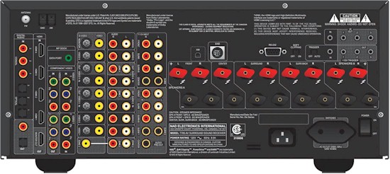

Nad T785 Back
The AM200 audio module provides traditional digital audio connections for coaxial and toslink with three of each for input and one of each for output.  The VM200 module provides HDMI v1.3 connections with 4 inputs and 1 output.  Additionally, the VM200 provides a port for connectivity with a separate iPod dock.  From the NAD website, future upgrades for these cards appear to include an updated VM module to support HDMI v1.4; assuming home 3D ever really takes off.
