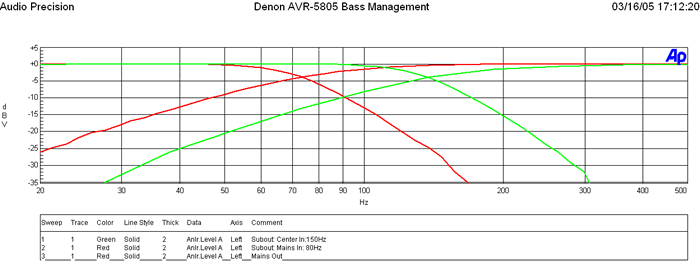

Discrete Multi Channel Measurement
Graph13
Red Traces: Main CH set to 80Hz and corresponding subwoofer output
Green Traces: Center CH set to 150Hz and corresponding subwoofer output
This is a plot of the subwoofer LPF and Main Channels HPF when set to the THX recommended 80Hz crossover setting (in red) and the center channel set to 150Hz along with its corresponding subwoofer output (in green). Notice in the red trace the HPF is down -3dB at 80Hz with a 12dB/Octave slope while the subwoofer is -6dB down at 80Hz with a slope of 24dB/Octave as per THX. Similarly for the center channel and corresponding subwoofer output at 150Hz the -3dB point of the HPF is 150Hz and the -6dB point of the LPF is 150Hz. Basically the AVR-5805 bass management is intelligent enough to have discrete LPFs corresponding to the HPF settings of each channel group. For 2CH sources, the LPF of the subwoofer is based on the HPF setting of the main channels as it should be.

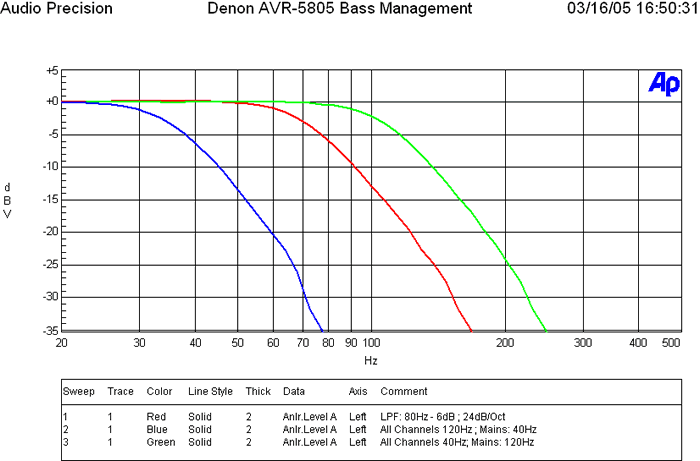

Let's take a closer look at the subwoofer output while varying the multiple crossover settings between the main speakers having high and low crossover settings, while the other speakers have low and high crossover settings, respectively. The AVR-5805 is configured in PLIIx Music Mode.
In the Blue Traces, we set all channels but the mains to 120Hz (extreme case), while the mains were set to 40Hz. Notice how the subwoofer crossover -6dB cutoff remains at 40Hz based on the main channels setting and we see no weird summing like we did in the Integra Research RDC-7.1. Granted, ideally it should have extended to the frequency of the satellite speaker with the highest crossover setting (in this case 120Hz), but I suspect Denon limited the cutoff of the LPF of the sub to the main channels setting to avoid excessive bass energy from a single source which is localizable at frequencies above 80Hz and to avoid having too much overlap of the speakers with HPFs set to a lower value.
Essentially the bass information from any speaker groups set above the main channels crossover point will not recombine bass back into the subwoofer. In other words, that information will be lost or extremely attenuated. In actuality the function is proper since the AVR-5805 was receiving a two-channel source and deriving a multi-channel surround output. It was defaulting the LPF of the subwoofer to whatever setting the main channels were configured too.
Overall, this multi-crossover system is the most flexible bass management system to date (a requirement for properly integrating the Audyssey MultEQ room correction system), and can be very effective if used within confined limits. We would suggest to always select satellite speaker systems with a -3dB point of 80Hz or lower, especially when using a product of this caliber in a full-blown high performance home theater system. We also suggest maintaining a difference of no greater than 20Hz between crossover settings of all speaker groups and using caution when setting the main channels' crossover setting too low (especially when listening to two-channel sources in surround sound) to avoid loss of bass information from the other channels. Always start at the 80Hz reference point and only deviate when absolutely necessary for your particular situation. In my system, I set all channels, including the LFE, to 80Hz (THX setting) except for the main channels which I set to 100Hz because I achieved better acoustical bass integration with my subwoofers and main satellite speakers.
