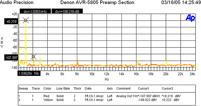

5805 FFT 1V
When the analog preamp was driven at 1Vrms (typically ½ signal strength to achieve ½ of max power of most power amps with voltage gain of 29dB) distortion levels were (+.0219 + 107.997)dBv = 108.216dBv (about 7dB better than what I measured on the Integra Research RDC-7.1 Processor ) or 100*alog(-108.216/20) = .000388%! The yellow trace represents "Pure Direct" mode, while the red trace represents normal stereo. As you can see they are virtually identical in performance which is testament to the excellent noise mitigation and layout of the receiver even when all functions are active.

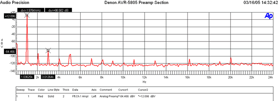

5805 FFT 4V
When I drove the analog preamp to over double the voltage required to achieve max gain of most power amps (4Vrms) distortion levels were very commendable (+12.096 + 84.466)dBv = 96.562dBv or 100*alog(-96.562/20) = .00149%!
