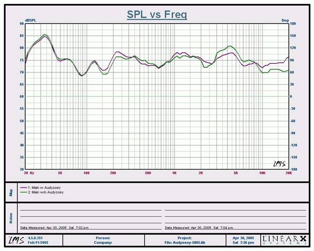

Audyssey Measurements
Graph1
In room, on axis measurement at the primary listening position, 1/3 octave smoothed
The Green trace represents the summed frequency response of my main channels and subs without Audyssey, while the Purple trace represents the same measurement with Audyssey engaged. As you can see the high frequency response past 8kHz is greatly improved and extended while the midrange performance between 3kHz to 6kHz is flattened out to match the overall response. I was surprised to see very little difference in low frequency performance, especially since I did hear an improvement in my listening tests. I can only attribute this to the fact I am using an analog input of the AVR-5805 and the Audyssey LFE filters may not be engaged when this type of signal is present.

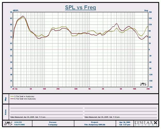

Graph2
In room, on
axis measurement at a far listening position, 1/3 octave smoothed
The red trace represents no Audyssey, while the gold trace represents Audyssey engaged. As you can see the overall frequency response is smoother and better extended with Audyssey engaged. What's most interesting here is that this mic position wasn't even placed at the exact position Audyssey calibrated for. Basically the spatial mapping of Audyssey was also improving the system's frequency response even at areas in between calibrated microphone positions.
Note: We are checking with Japan to verify that the latest firmware version has been installed. In conversations with Audyssey, their results indicate we should be seeing more effective bass correction than these measurements reveal. A review addendum will follow once we have more information.

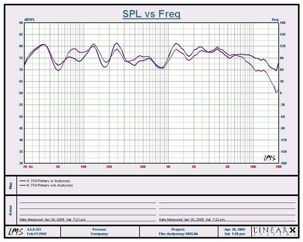

Graph3
In room, mic vertically oriented at primary listening position, 1/3 octave smoothed
Just for fun I pointed my LMS mic straight in the air at my primary listening position and engaged 7CH Stereo mode on the AVR-5805. The purple trace represents no Audyssey, while the blue trace represents Audyssey engaged. It's quite impressive as to how much flatter and more extended the system's high frequency response from 5kHz to 20kHz is when Audyssey is engaged. The overall low end response also seems a bit flatter, probably due to the summed flattened response of all the channels.
