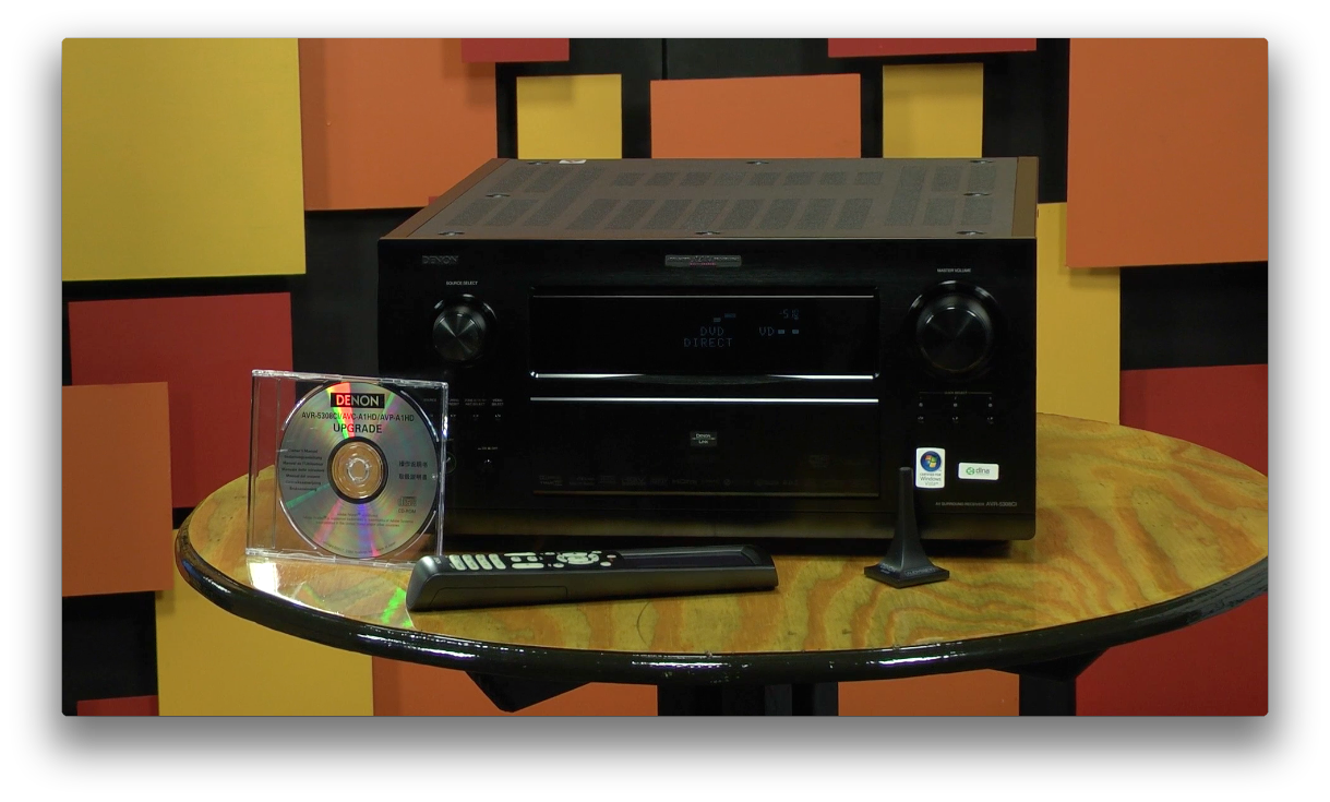

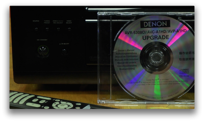

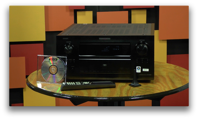

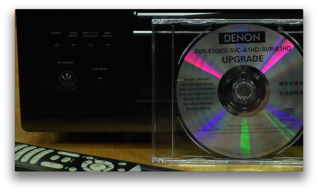

upgrade CD

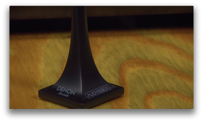

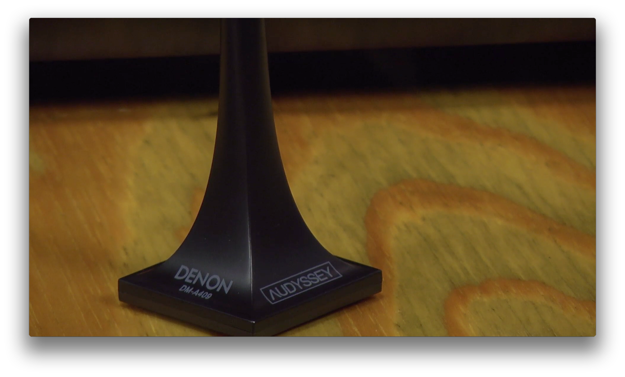

As for the audio enhancements, Denon bumps the 5308 to MultEQ XT32. XT32 has, quite literally, 32 times the filter resolution of the original MultEQ XT. Like MultEQ XT, and UNLIKE several other EQ systems on the market, the filters are applied to ALL channels including the subs. And really, in most systems, it's the subwoofer response calibration that benefits a room the most. With the included calibration mic - a new model that comes with the upgrade - you can take measurements from up to 8 different positions - 32 with a MultEQ Pro kit.

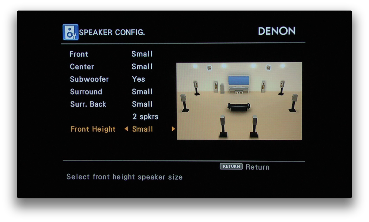

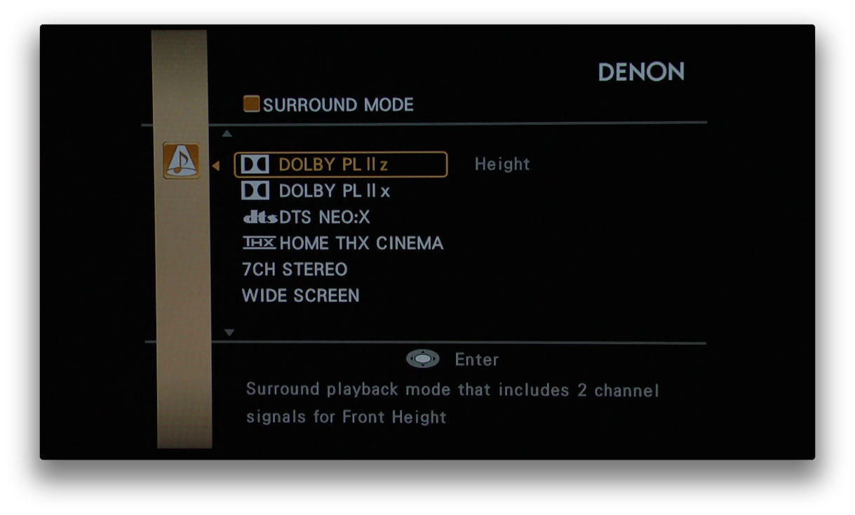

The new Denon update also adds the new surround modes that incorporate Height and Width channels. The first, is Audyssey DSX which is designed to produce a bigger surround sound experience. On the Denon, Audyssey DSX can do 7.1 and 9.1 surround using a combination of Height and Width channels. DSX is also scalable, so you can build or expand your system over time. Along with Audyssey DSX, Denon added dts Neo:X, which can use both Height and Width channels and Dolby Pro Logic IIz which adds Height channels to 7.1 surround.
PL IIz front height channels

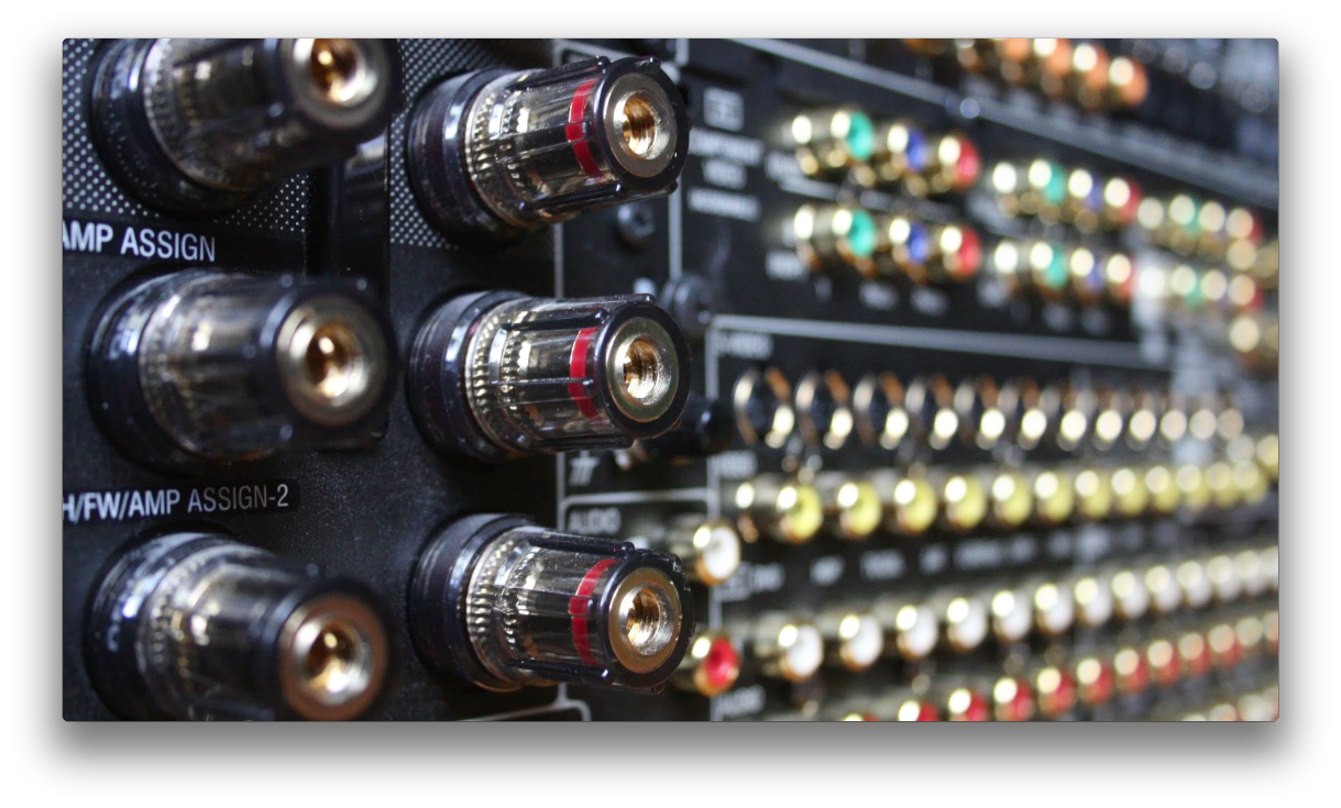

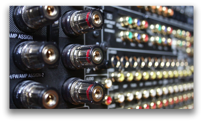

rear panel angled
