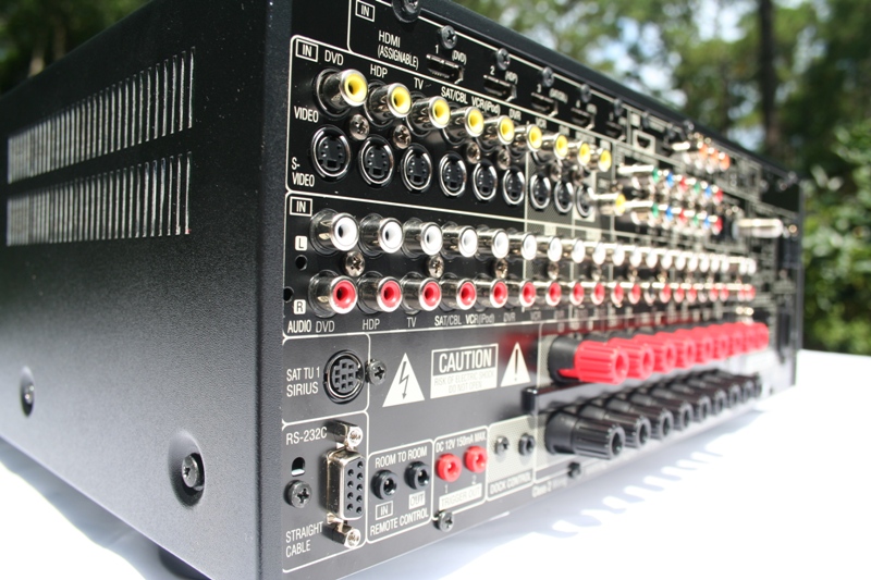

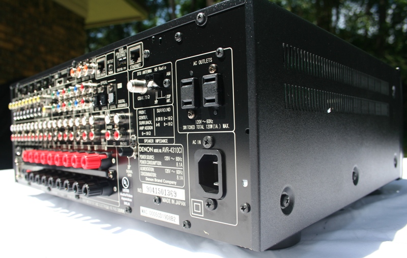

AVR4310CI_back_angle1You'll want to connect up all your speakers and sources as well as the antennas for your satellite, terrestrial, and HD radios. Also, don't forget to connect an Ethernet run to your router. If you don't have a dedicated Ethernet run to your home theater (and many don't) you can use one of the PowerLine solutions that are available from a number of companies (including the one we reviewed from Belkin). You probably won't be streaming anything that will require full bandwidth so these solutions should be more than enough. While you may not ever use the Ethernet connection for streaming, it is handy to have around for firmware updates (which the Denon AVR-4310CI will let you know about). If you are happy with the performance and features of the unit out of the box - well, maybe you can skip this. But if you do, remember that you'll have to disconnect everything and drag your receiver into your office for updates or else buy a super-long Ethernet cable to use when you find out at a new feature is available.

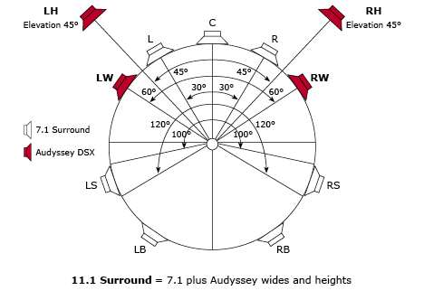

AVR4310CI_DSX111The Denon AVR-4310CI has a full compliment of auto setup and calibration options as well as a number of user-configurable features that need to be addressed. Audyssey and Denon have had a long history together and the AVR-4310CI is no different. Audyssey's MultEQ XT is the top of the line from the company which strives to make every seat the "best seat" for playback. We've covered this technology before so we won't go into much detail here but understand that Audyssey's technology is fundamentally different from the rest of the solutions out there which used parametric EQs. On top of that, the AVR-4310CI has the brand new DSX (stands for Dynamic Sound eXpansion) processing which adds height or width channels to the front of the room. These speakers are to be placed (according to Audyssey) at about 45degrees off center and pointed down at 45 degrees to the main listening position for height or off center 60 degrees at ear level for width. While Audyssey DSX has the ability to do up to 11.1 surround, the AVR-4310CI has 7 internal amps and two assignable analogue outputs for a total of 9.1. (Edit - turns out you can't assign the pre-outs separate from the internal amps so this receiver is hamstringed at a grand total of 7.1.) Since it also supports Dolby Pro Logix IIz which also has front height channels, we recommend that if you are going to install these extra speakers, you go with height over width.
AVR4310CI_back_angle2You may have noticed the extra pair of speaker terminals labeled "Surround Speaker B." These are essentially the same as your surround speakers but are only used for multichannel music. The same information is sent to each pair of terminals but the difference is that the A terminals are meant to be utilized for speakers placed to the sides of the listening area and elevated while the B terminals are designed to be connected to speakers that are slightly behind the listening position and at ear height. When you enable a music mode, the Denon automatically switches the amps to the appropriate surround speakers. We would have liked Denon to make these terminals assignable as well so that the user could switch on the fly from a 7.1 configuration to a 5.1 with powered Zone 2 or 3 without having to switch cables. The Surround Back terminals can be assigned to Back speakers, either of the extra zones, or to Bi-amp the front speakers.
