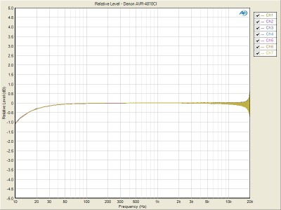

Frequency Response & Power Bandwidth
4310-rel-level-amp
Figure 1. Denon AVR-4310CI Frequency Response Variation
With all seven channels simultaneously driven, we compared the frequency response of each driving an 8 ohm load. As you could see the frequency response variation between channels is excellent measuring -1dB at 10Hz all the way to +-0.5dB at 20kHz.

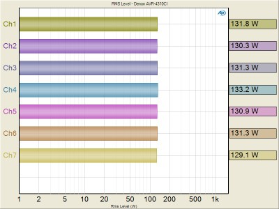

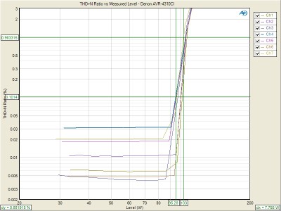

With the new APx585, we are now able to do a full barrage of multi-channel amplifier testing. We tested power using three methods all of which were taken at < 0.1% THD + N:
  • Continuous Full Power Bandwidth (CFP-BW) from 20Hz to 20Khz into 8 and 4 ohm loads (up to two-channels)
  • 1kHz Power Sweep vs Distortion (1kHz PSweep) - popularized by the print magazines, this is an instantaneous power vs distortion test at 1kHz. The problem with this test is it often masks slew related and or frequency response problems some amplifiers exhibit at the frequency extremes, and thus inflates the measured power results. It does provide an instant gratification # for consumers to argue over on the forums so we are now incorporating this test to please the masses.
  •  1kHz CEA-2006 Burst Method testing. This is a dynamic power measurement adopted from the car industry similar to IHF method only a bit more difficult for an amplifier and more representative of real musical content.
 4310-1khz-PWR
Figure 2. Denon AVR-4310CI PSweep-1kHz Power Testing
 4310-7CH-PWR-burst
Figure 3 Denon AVR-4310CI CEA2010 Dynamic Power Testing
 4310-PWR-graph-8ohm     4310-PWR-graph-4ohm
Figures 4 & 5. Denon AVR-4310CI Continuous Power vs Frequency (8 ohms left, 4 ohms, right)

The Denon AVR-4310CI proved to be a true powerhouse for its price class. We honestly weren’t expecting such stellar results in a sub $2k receiver that is jammed packed with features. It was able to exceed its continuous fullbandwidth per channel power rating of 130 wpc by delivering a whopping 163wpc into 8 ohms and 267 watts into 4 ohms. With the standard 1kHz ACD test, the AVR-4310CI delivered 95 wpc which again is excellent. The AVR-4310CI should be able to power most moderately efficient loudspeakers to deliver theatrical power levels in medium to large sized theater rooms.

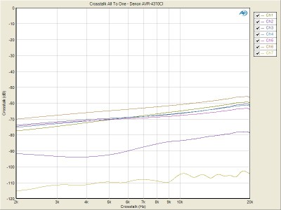

Crosstalk
XTALKanalog-amp-all-2-one
Figure 6. Denon AVR-4310CI All to One Crosstalk
Sweeping from 2kHz to 20kHz on all channels as the noise disturbers but the one under test as the noise, I measured the residual noise of each channel individually and repeated for all seven channels.  This is the worst possible test scenario . The overall results were good to stellar. The good was around 60dB of isolation at 20kHz for the surround back channels while the stellar was > 90dB at 20kHz for the main channels. Anything below 60dB at the high end of the frequency spectrum is generally considered to be sufficiently inaudible so there is no cause for alarm here despite the measurable variances between the channels.

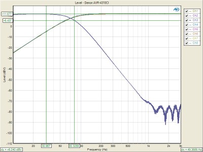

Bass Management
As with virtually all modern Denon A/V receivers, the bass management facilities on the AVR-4310CI was top notch. We measured a perfect THX type response with the crossovers set to 80Hz where the subwoofer was at -6dB at 80Hz exhibiting a 24 dB/oct rolloff while the satellites were -3dB down at 80Hz with a 12 dB/oct rolloff as can be seen in the measurement below (Figure 7).
 4310-bassmgmt
Figure 7. Denon AVR-4310CI Bass Management
