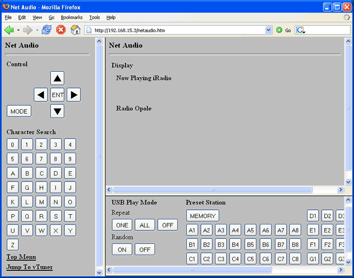

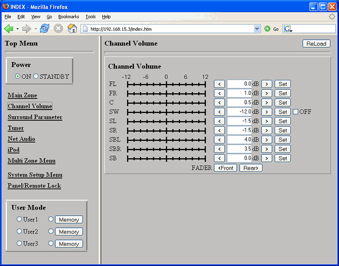

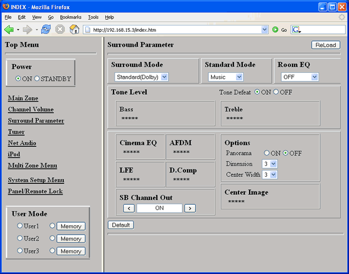

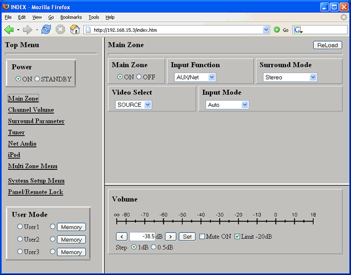

One surprising advantage of adding the new network features is that the Denon AVR-4306 can now be "remote controlled" via any web browser located within the same network as the receiver. This offers more than just a little control over functions such as Main Zone, Channel Volume, Surround Parameters, Tuner, Network Audio, iPod, Multi Zone Control, System Setup and Panel/Remote Lock. Here are a few screen captures to let you know what this interface looks like:
The Main Zone and Channel Volume adjustments are present in the web interface
Here the Surround Parameters and Net Audio functions are shown
All you need to do to call up this browser interface is type in the IP address of the receiver (which you can find under the Network Setup submenu item.) The receiver will require an Ethernet cable connection to your local network of course and, if you are running a DHCP server, it will pick up an IP address automatically. At this point it will be accessible from any web browser for remote control and configuration of the unit.
