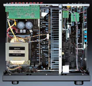

Build Quality
denon_AVR3805_top.jpgThe Denon AVR-3805 not only performs well, but also has an exceptional build quality for its $1199 price tag. Based on the fuse rating of 7.1 amps, we can deduce that the power transformer is around 850VA (7.1A x 120V). Taking into account amplifier and power supply efficiency and processor overhead, true output power in 7-channels all-channels-driven would be about 850 x 0.7 舑 50 = 545 Watts / 7 = 77 watts per channel assuming the receiver doesn't have built-in current limiting. It features a very hefty equal power amplifier section, with discrete output devices on all seven channels. It has a large power transformer that takes up nearly 1/6th of the interior of the receiver and is coupled with a rectifier diode and oversized block capacitor to stabilize the power at high output levels.
The heat sink for the amplification section runs the entire length of the unit and provides ample cooling for the AVR-3805, even during extended home theater use. I ran it through several movie nights and didn't find it to be excessively hot, even directly over the heat sink.
