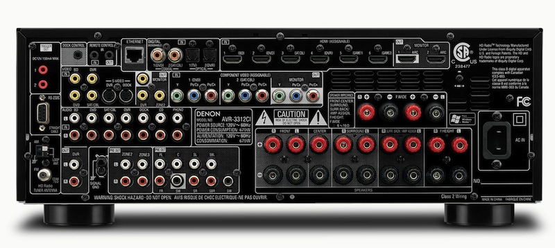

Denon rates the AVR-3312CI at 125 watts for each of the seven channels all with discrete amps. There are a ton of connections on the back but what is important is that it has seven (included on on the front) HDMI 1.4 inputs with 3D support. We couldn't find any information on the Denon website on Audio Return Channel or HDMI Standby Pass-thru bu that doesn't mean it doesn't support it. It just isn't listed anywhere. We did notice an ARC label next to the dual HDMI outputs so we suspect that Audio Return Channel is supported. There are two component video inputs, five (one front mounted) composite video inputs, two s-video, two coaxial and three (one front mounted) optical digital inputs, and a slew of analogue audio. While there are no 7.1 channel analogue audio inputs for integrating legacy gear, there are 7.2 channel pre-outs for adding external amps and two subs. There are pre-outs for two additional zones of audio, a composite video output for Zone 2, and the back amps can be routed to power those zones as well.
As you'd expect with Denon, Audyssey is on board with their MultEQ room correction, this time with the XT pro system. This allows installers to fine tune the room response. There are five way binding posts for all seven channels plus provisions for two additional pairs of speakers for changing your configuration on the fly without having to switch wires. This allows you to utilize the height channels of Dolby ProLogic IIz or the height or width channels of Audyssey DSX at will (you just need to reassign the amps from the menu). All the latest HD audio formats and DSPs are on board. Denon has included upconversion to HDMI of all analogue sources as well as upscaling to 1080p over HDMI. They didn't name the chipset that is performing these duties which may mean it is a proprietary one.
