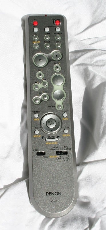

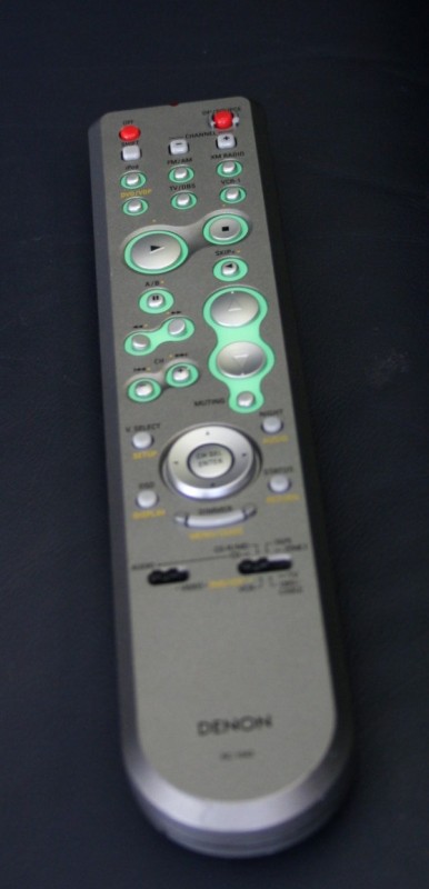

Remote Control
Remotes, I love to hate
them. There are a lot of reasons (mostly because they are an afterthought and
universally stink) but in the case of the Denon AVR-2307CI I’m finding a lot to
like here. First of all, it is shaped like a scrap piece of 1”x3” with
absolutely no ergonomics. It’s ugly, grey, the mute button is too close to the
“night mode” button, and not back lit (well, kinda – it has some
glow-in-the-dark material around a few of the buttons but it wasn’t until I
took the remote outside that it absorbed enough light to actually glow – and
this was after weeks of testing). The
last one is really the only thing that brings it down in the ratings for me.
Why? A number of reasons:

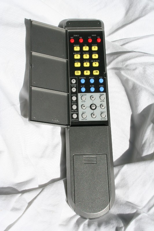

- But most of all because there is a second control panel under a cover on the back of the remote.
The second panel is great in that it houses all the inputs buttons on the front plus a few that aren’t, the DSP and Surround mode buttons, Zone 2 power, and the System Menu button. This has a number of glorious applications in my mind including:
- The ability to “hide” some inputs from unknowledgeable guests and prying children
- It keeps most of the setting buttons away from everyone else (an extra layer of protection above the Setting Lock in the menu)
- It is just a nice elegant way to free up real estate on the front of the remote
Now however un-ergonomic the shape of the remote is, using the back makes it worse. But as they’ve mostly put buttons back there you a) don’t want people to have access to or b) won’t use very often, I’m OK with it. My wife hates the remote (says it isn’t as responsive as she’d like) but all in all, I like this sneaky little remote.
