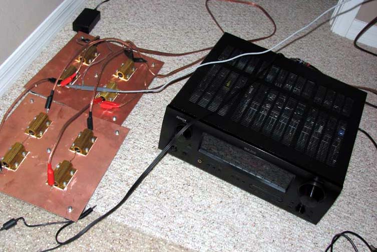

The AVR-2308CI delivered a whopping 150wpc into 8-ohms and 211 watts into 4-ohms at 0.1% THD + N using my APC S-15 and SBATT to ensure the line stayed at 120V +- 2V. With 2 channels driven, it measured around 130wpc into 8 ohms and 190wpc into 5 ohms. Keep in mind most review publications test at clipping and don’t do continuous power measurements so our power numbers are usually a lot more conservative than what you typically find from other reviewers yet this receiver was delivering FAR more power than its rated specification of 100wpc.

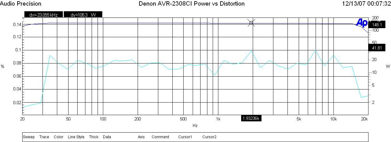

Power Bandwidth
2308CI Regulated Power

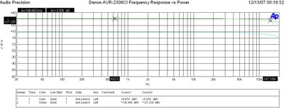

Figure 1. Denon AVR-2308CI Frequency Response vs Regulated Power
Using input regulation where I set the Audio Precision SYS 2722 to regulate the output distortion to less than 0.1% THD + N, the AVR-2308CI belted out around 150wpc across the entire audio spectrum (20Hz to 20kHz).

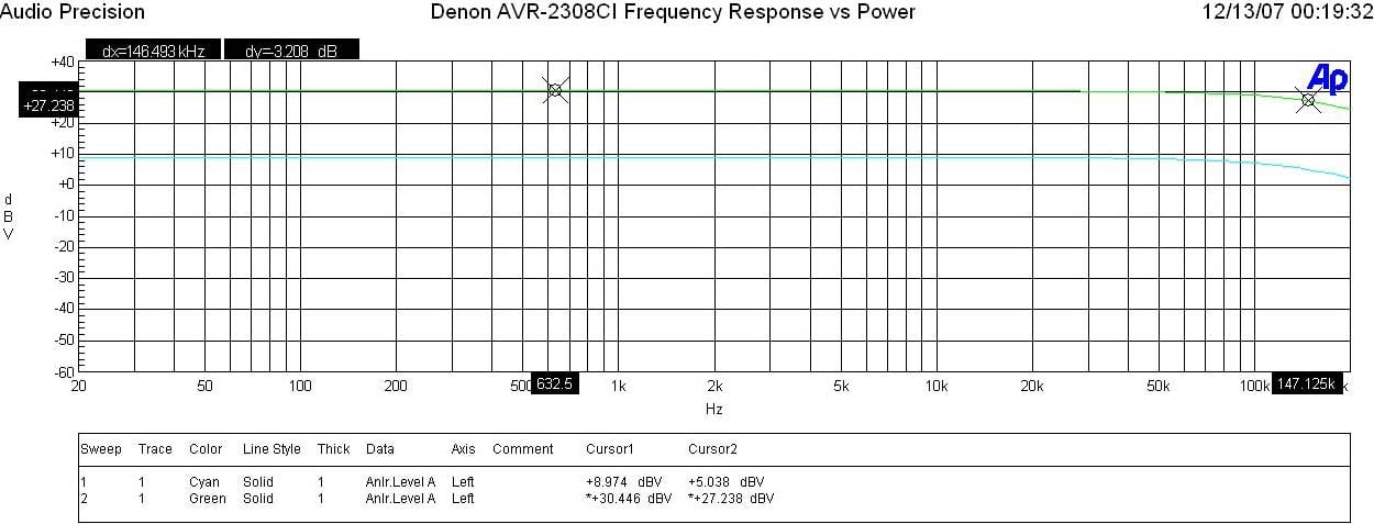

Figure 2. Denon AVR-2308CI Frequency Response vs Power
Whether I was driving the AVR-2308CI at 1 watt or full power, the amplifier section exhibited excellent frequency response uniformity with a -3dB point of around 147kHz.

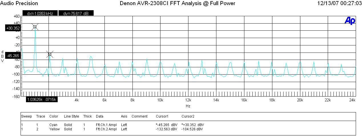

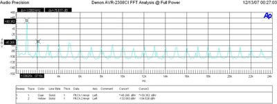

FFT Distortion Analysis
AVR-2308CI FFT Analysis
Figure 3. Denon AVR-2308CI FFT Analysis @ Full Power
At full measured power AVR-2308CI again exhibited excellent distortion measurements (30.352 + 45.265)dBv =75.6dBv or 100*alog^-1(-75.6/20) = .0166 THD + N which is a respectable measurement.

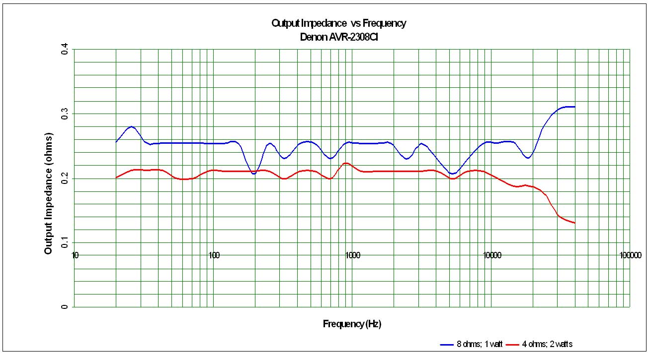

Figure 4. Denon AVR-2308CI Amplifier Output Impedance vs Frequency
The amplifier output impedance was a good margin higher than our 100 mohm or less mark I’d like to see on uncompromising designs, but it was still very linear and under a few hundred milliohms which would make it quite capable of driving a wide diversity of loudspeakers with consistently good performance.

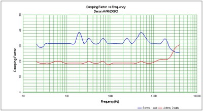

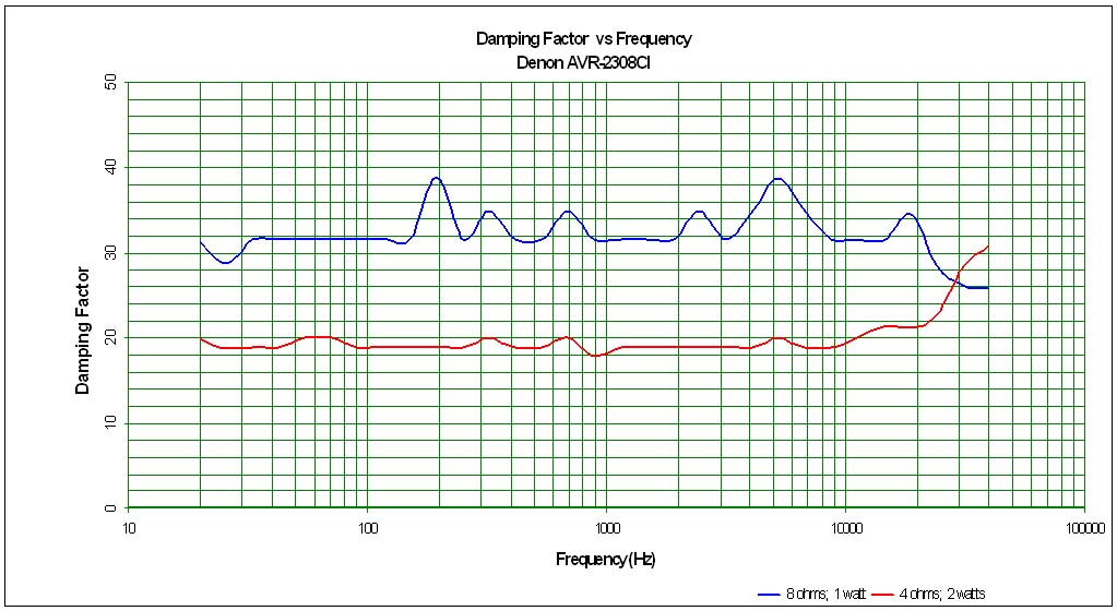

AVR-2308CI Damping Factor
Figure 5. Denon AVR-2308CI Damping Factor vs Frequency
The amplifier damping factor is about what I expected based on the measured output impedance. It is uniformly good across the entire audio frequency range but does fall shy of our 100 mark for uncompromised designs. The good news however is the amplifier doesn’t fall apart when driving low impedance loads like I’ve seen on some models in this price range in the past.
