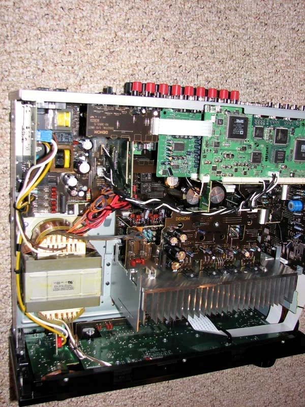

The Denon AVR-2308CI’s build quality is what I’d expect from Denon at this price point. Sturdy construction, with a brushed aluminum faceplate, detachable power cord and binding posts for all speaker connectors come standard on this unit. The chassis is certainly well secured as I had to remove 11 screws just to get the top cover off to take this picture. The power supply is about average from what I’ve seen in this price class, sporting a decent sized power transformer and two 85 deg C rated 12,000uF 71V power supply capacitors. Denon didn’t skimp on putting a nice solid aluminum finned heat sink in this receiver as so many other companies tend to do at this price class. It’s an indication to me that this baby’s got more juice than the spec sheet shows as we will soon find out on my test bench.
Editorial Note
In order to hit the rated 100wpc Denon is claiming, they would require a rail voltage of sqrt(2)*[(100*8)^1/2 ] = 40V + 5V(margin) = 45V. As you can see their capacitor bank has plenty of overhead to meet this requirement.

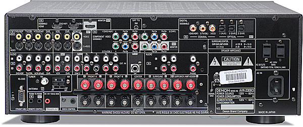

Back Panel View of the Denon AVR-2308CI
The AVR-2308CI certainly has an impressive backside but it is lacking one feature I am mildly disappointed in – preamp outputs to connect external amplification. I understand however at this price, Denon is banking on most people not pairing this receiver with other amplifiers, but as I found when reviewing this receiver, it’s got a heck of a good processor section that would serve quite well as an inexpensive pre/pro for someone to pair with their more powerful stack of amplifiers. Well, it would have if Denon included preamp outputs. Since they didn't on this model, you will have to settle with using its internal amplifiers to power all of your speakers.
The AVR-2308CI has two HDMI 1.3a inputs and 1 monitor output, 3 coax and two toslink digital inputs, and one toslink digital output. The detachable power cord and 150mA high current 12V trigger was a nice touch at this price point. I can think of many products at 4 times this price that still utilize wimpy 10 or 15mA triggered outputs which wont work with most motorized screen systems and power conditioners. Kudo’s for Denon on using an extra current amplifier stage to make this port more useful to the integrator and end user.
