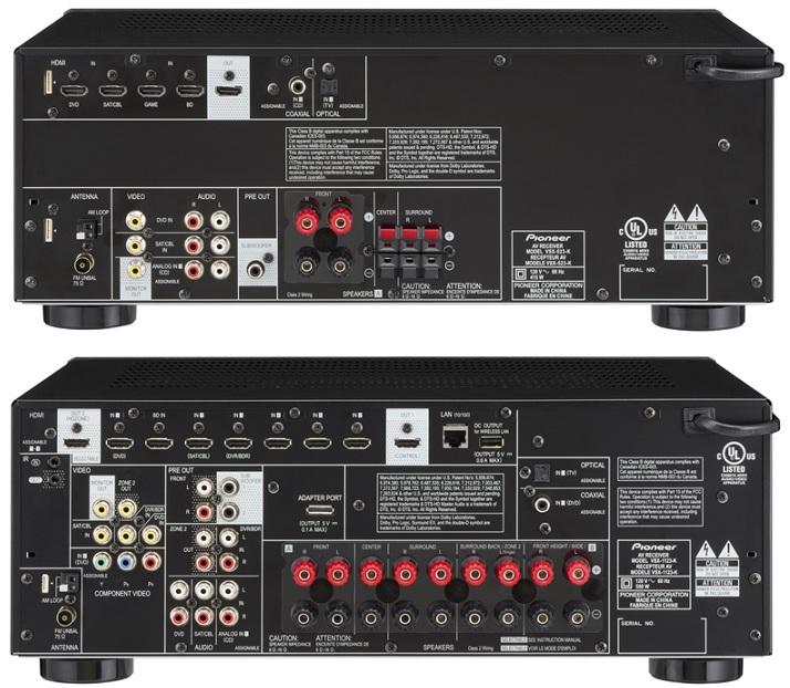

Filling the entry level slot at $279.99 is the VSX-523, a 5.1 channel receiver boasting 80 watts per channel into 8 ohms (though it is not specified how many channels are driven). Featuring four HDMI inputs and a single HDMI output, the VSX-523 also has a single digital coaxial input and a single optical input as well as three sets of stereo analog inputs (and a pair of composite video inputs and one output). Speaker outputs take the form of 5-way binding posts for the front left and right channels, and spring type connectors for the remainder of the powered channels. Naturally, to fill in the .1 channel, the VSX-523 sports a single subwoofer pre-out as well.

Rear view of the VSX-523 and VSX-1123 for comparison.

Rounding out the lineup is the top dog VSX-1123 at $629.99. What more could Pioneer give you, one might ask? Well for starters, you get a marginal increase in power, from 80 watts per channel to 90 watts and a bump up to 8 HDMI inputs and 2 outputs. The second HDMI output can be a clone of the first or from a second separate source. The VSX-1123 exorcises all of the chintzy spring clip connectors in favor of binding posts for all channels (including front heights/wides), and offers a set of pre-outs for the front left and right channels as well as a bump to two subwoofer pre-outs. Overall, we'd say this isn't too bad for an extra $100 over the VSX-1023.
