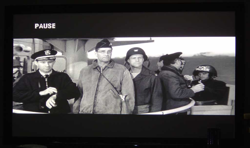

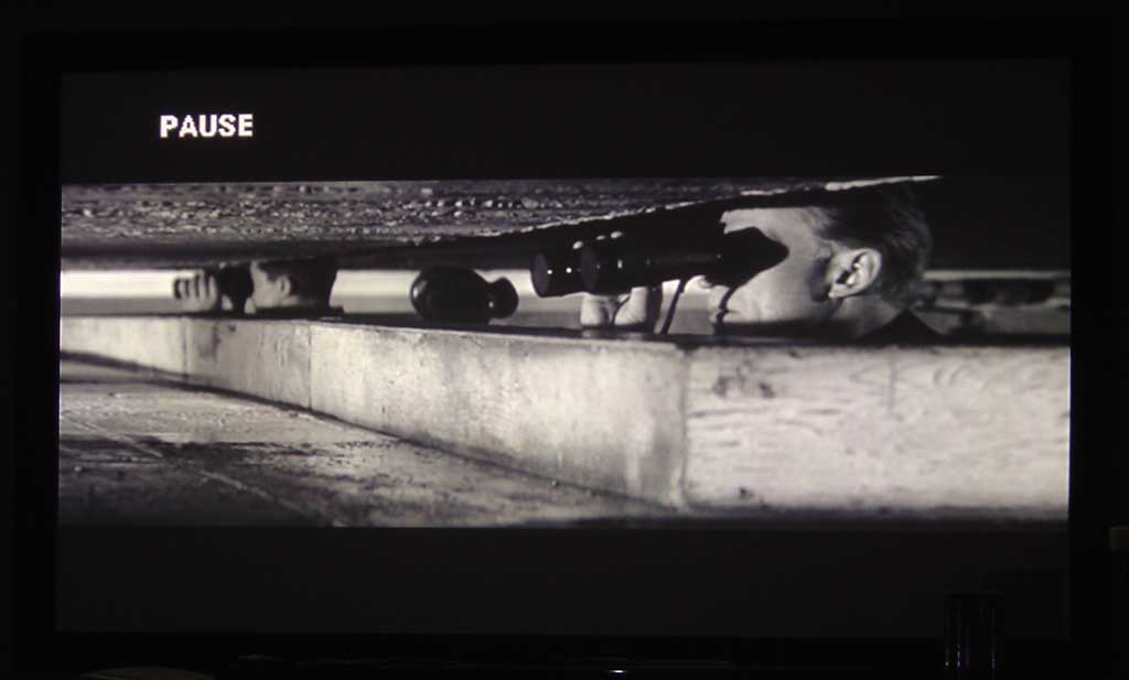

One of the neatest and highly effective menu options of the LPX-510 is its ability to quickly adjust the absolute color temperature. This is the color temperature that will represent neutral gray on the projector. For ISF calibration you'll want this set to 6500K (this varies according to picture mode, but we'll assume light-controlled room and cinema use for now). ISF isn't rigid in its use of color temperature however, as even they realize that when used properly, color temperature can serve useful purposes outside of the typical 6500K setting. For instance, let's pop in a nice black and white movie, like The Longest Day - one of my personal favorites, though not the greatest DVD transfer:

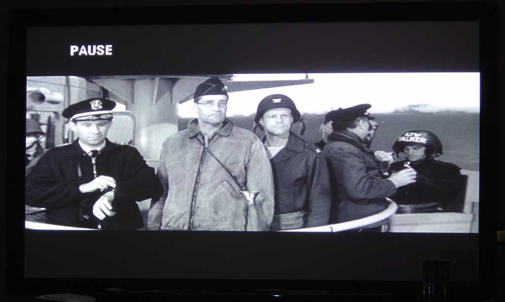

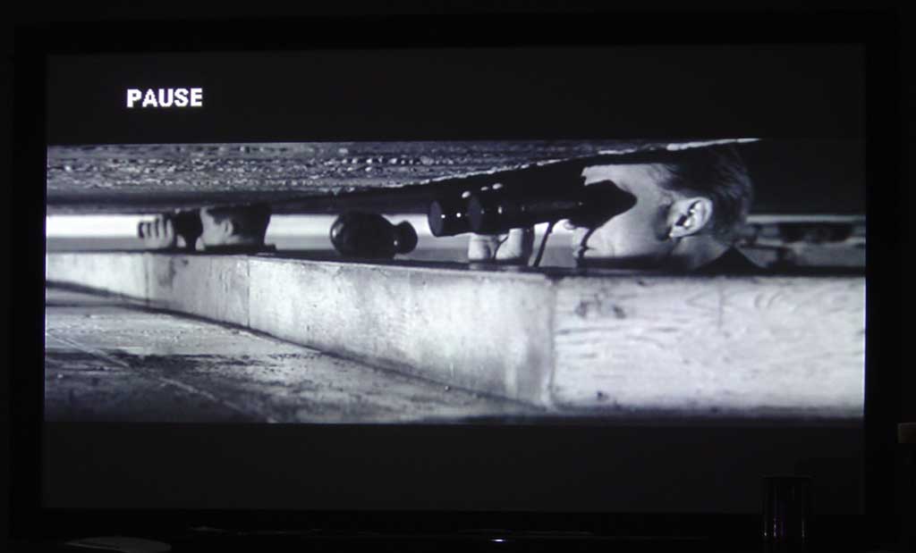

Looks good, right? There is a nice clean representation of the picture and excellent contrast ratio and black levels (for the transfer, anyway). The trouble is, projectors used back in the days of black and white film had bulbs that ran at 5400K. So watch what happens when we set a memory setting containing an Absolute Color Temperature of 5000K:
The picture goes from good to excellent . In addition to looking more accurate to its roots, the 5000K setting is much easier on the eyes and makes for a more pleasing movie experience. Once set it's easy to see just how blue the 6500K looks on black and white film. Try A-B'ing this setting with your friends during a showing of Casablanca or a good John Wayne western and you'll be sure to get some pleasantly surprised reactions. This is how black and white is supposed to be viewed.
