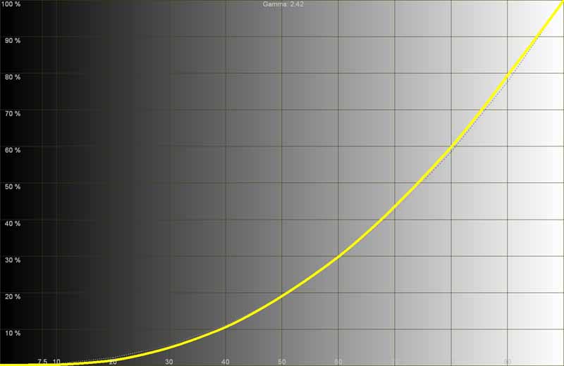

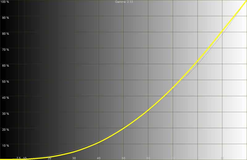

When performing calibration it's important to turn off any Auto Iris functions. The results will not be consistent, nor correct if you leave it on and what will invariably occur is a resulting S-type gamma curve. Looking below we see the before and after gamma measurements.
Before we measured a Gamma of 2.42 (left); After calibration yielded a Gamma of 2.33 (right)

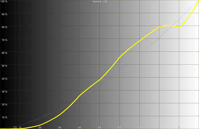

If you leave the Auto Iris on (don't do this), this is what you will end up with following calibration:
Holy wiggly line, Batman!

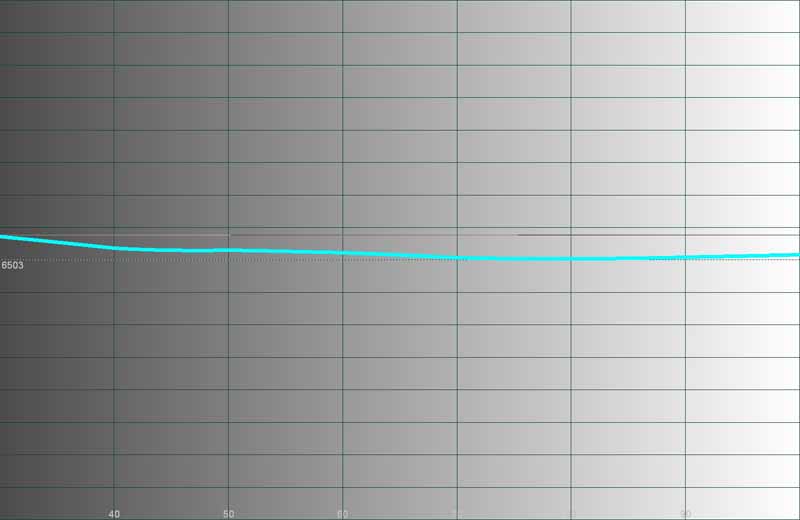

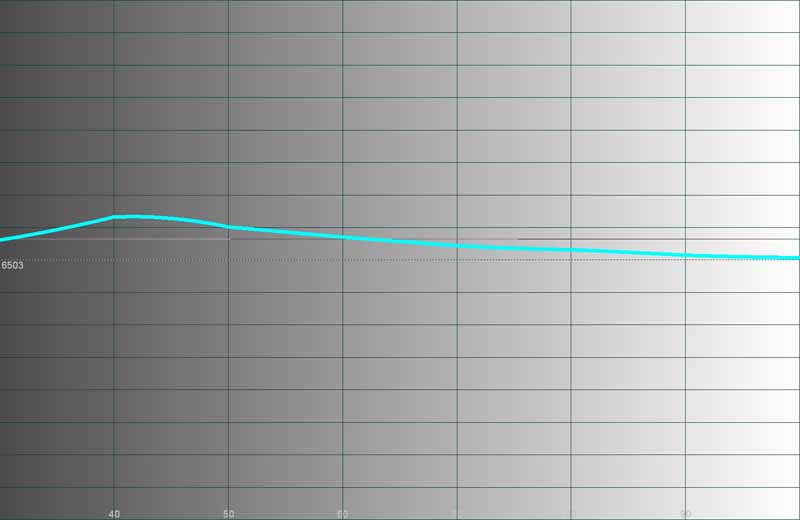

Color temperature wasn't awful before calibration, but got much better with a custom RGB calibration:
Before calibration (left); After calibration (right)
Color temperature dialed in nicely as well:
After calibration we dialed in the color temperature much closer to our 6500K target.
