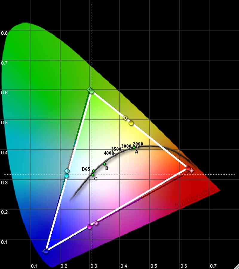

PLV-Z60-CIE.jpgThis is the part I love. Seeing if my eyes told me the truth about how this projector looks. Measuring a projector and then calibrating it is the best way to see what you get out of the box and what you can get when the product is tweaked. Before testing we ensured that any "auto" modes were disabled. This included Auto Black Stretch, Transient Improvement, Contrast Enhancement and Dynamic Gamma, all of which are located in the Advanced menu. The lamp Iris was also set to Close so that it didn't ramp up and down as we made adjustments to the RGB levels. Color was excellent, and better than many projectors I've tested at more than twice the price of the Sanyo PLV-Z60.

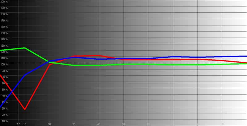

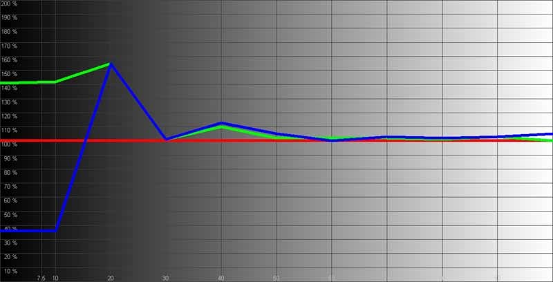

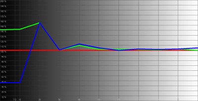

Taking some measurements I came very close to saying that this projector really doesn't require calibration. The truth is that it doesn't - not to look good, but it can look better with some adjustments to the RGB gain and offset levels. Here are some of the before and after measurements as measured by our reference Datacolor ColorFacts Professional software:
RGB levels before calibration (not bad at all)
RGB levels after calibration (tighter)

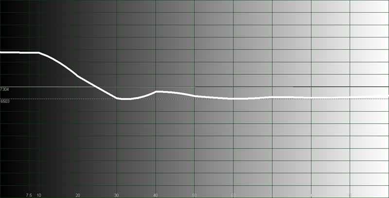

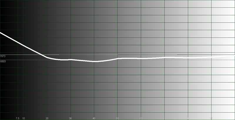

If RGB levels were barely brought in line, looking at the color temperature measurements yields a similar picture:
Color temp drifts above 6500K as light output levels increase

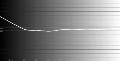

Calibration brought us nearly perfect to 6500K from 30 - 100 IRE

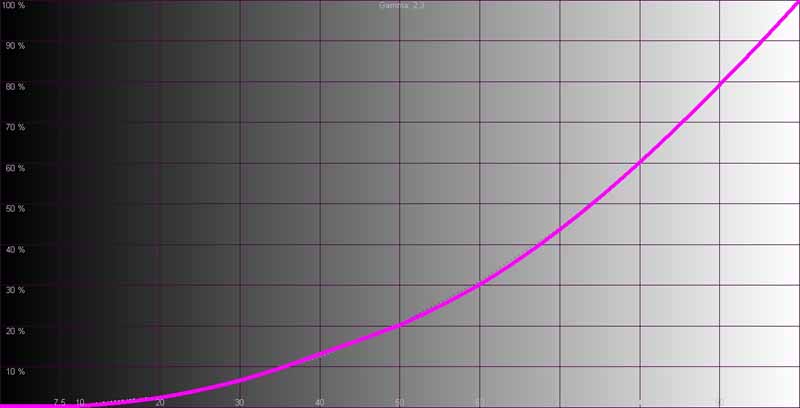

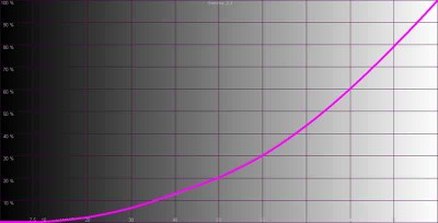

The gamma curve looked smooth and stayed almost unchanged (at ~2.3) before and after our calibrations:
