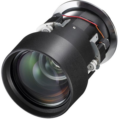

The projector and lens ship separately, this is because you can order any of six (6) different lenses to meet your needs.
| Type | Model | Throw Ratio |
| Standard | LNS-S11 | 1.6 – 2.1:1 |
| Wide Angle Zoom | LNS-W10 | 1.2 – 1.6:1 |
| Wide Angle Zoom | LNS-W11 | 0.8:1 |
| Long Throw Zoom | LNS-T10 | 2.1 – 3.4:1 |
| Long Throw Zoom | LNS-T11 | 3.4 - 5.4:1 |
We requested and received the LNS-S11 short throw lens, which allowed us to fill a 100-inch screen from our mounted position. Installing the lens was simply a matter of removing the protective lens cover from the projector, correctly lining up the lens by matching the red lines on both the lens and the body, and inserting the lens and twisting it clockwise. The LNS-S11 costs about $1000 retail, but you can easily find it with a street price under $600. It's important to note that these lenses are motorized, so focus and zoom functions are controlled via the projector – a nice feature for any presentation or multimedia system.
