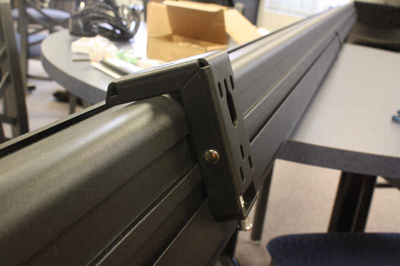

installation bracketsThe VApex Tensioned Screen came in a well-padded box. There was no shipping damage, despite the fact that the screen was over 11 feet long. Opening it up, we quickly took in the black aluminum casing and noted the rear rails that allowed for easier flexibility of placement. We've seen screens that had very restricted bracket positioning, but the VApex allows you to take advantage of nearly any nearby stud or fastening location to get it mounted. The wall/ceiling brackets were made well and had a unique system to allow the screen to be mounted and positioned prior to locking down the clamps and preventing any shifting of the screen enclosure.

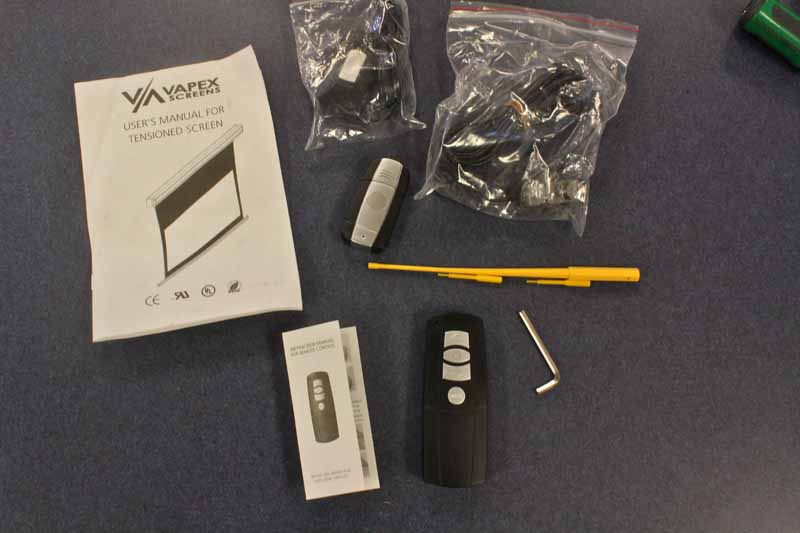

The 120" VApex Electric Tensioned Projection Screen includes:
  • RF remote control with laser pointer
  • Wireless RF 12V trigger system
  • 3-way wall switch
  • Removable power cord
  • Sliding L brackets
  • Vertical limit adjustment tool
  • Wireless 12V trigger tool
  • Allen wrench for adjusting tension
  • Mounting hardware for stud & masonry walls
accessories
