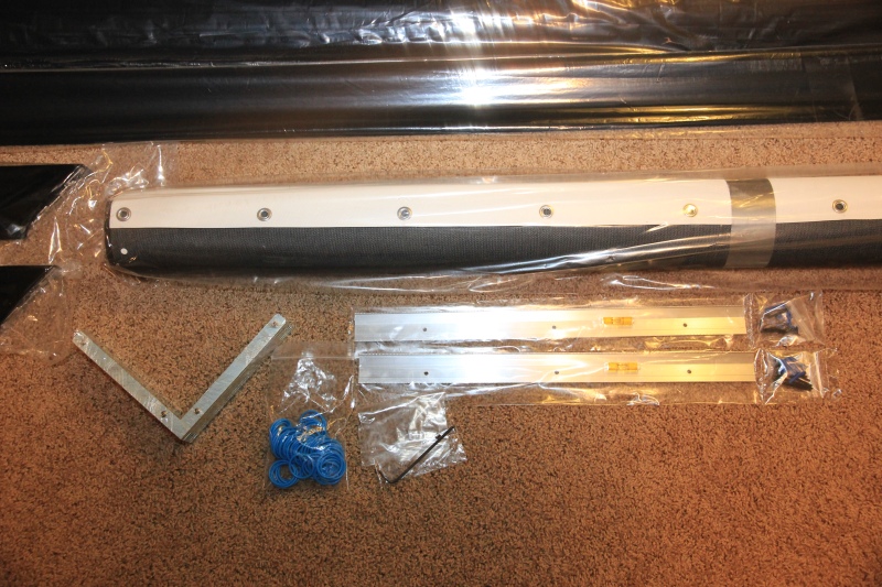

One’s perception of the product always starts with unboxing.  I personally live 40 minutes from the Seymour AV factory, so I opted to pick the screen up instead paying for shipping.  While there, I did see other screens in boxes, and they seem very well packed!  Thick foam ends, heavy walled cardboard boxes, and Chris informed that FedEx is the preferred shipper here in the US.  Considering the famous YouTube video of FedEx chucking a TV over a tall fence, I would consider this screen quite a bit safer for shipment due to the lack of glass and good quality packing.  None the less, I didn’t ask for an eight foot drop test.  The screen and border do come all wrapped in thick plastic and bubble wrap to protect them from factory or shipping damage should the box rip open and sand or dirt gets inside.  Four Sides, eight corner brackets, the screen – two layers in my configuration, blue rubber o-rings, mounting rails and hardware are all included.

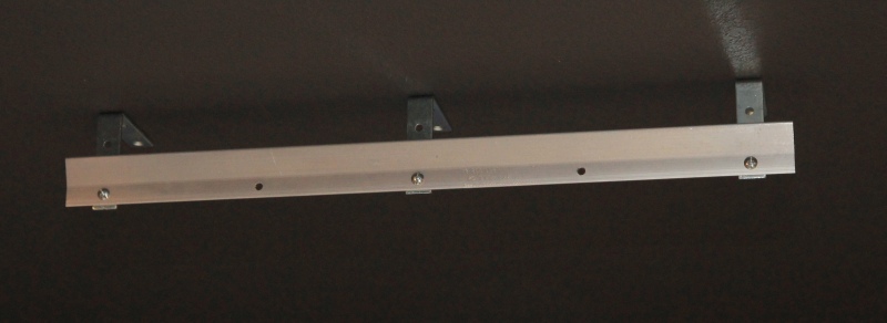

My particular screen installation was probably a bit different than the average person as I wanted the screen to hang down directly from the ceiling instead of against a wall.  I was able to add 6 L-brackets and some bolts from my local hardware store and still use the mounting rails supplied.  Also, since the screen was going to be several feet from the back wall, I opted for the Black Backing layer so there would be virtually no shadow of an image for viewers positioned far to the side.  Typically, the included brackets should be mounted at about the 1/6 and 5/6 image width locations.  Making sure they are both the same height and mostly level isn’t too time consuming, but please note that at least one hole in both brackets should hit a wall stud and that an uneven ceiling may affect how square the screen looks once it is hung.  There needs to be a small margin of space above the brackets for the screen to hang on as well.

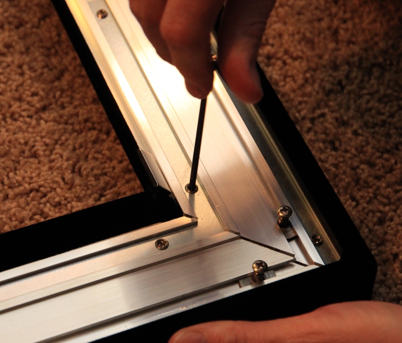

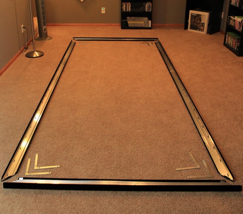

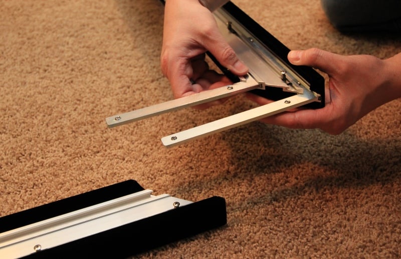

corner bracketsOnce the hanging rails were in place, assembly began!  The screen I ordered was 130” wide so I was a bit skeptical about the screen coming out perfectly square on the corners.  My fears were unfounded as there were two 3/16” thick steel brackets for each corner that tightened down with 4 locking screws each.  Sliding the brackets in was quick, but the corners need to be held together while tightening the screws.  The included hex wrench made it easy, and even if I didn’t hold the corner super tight, there was still no visible gap on the front side due to the thick black border wrapping around the edges.  There is also some adjustability in the corners in case I needed the height to be a little tighter or looser for the panels to fit perfectly.  I didn’t do this initially and we’ll discuss the panel fit later on.

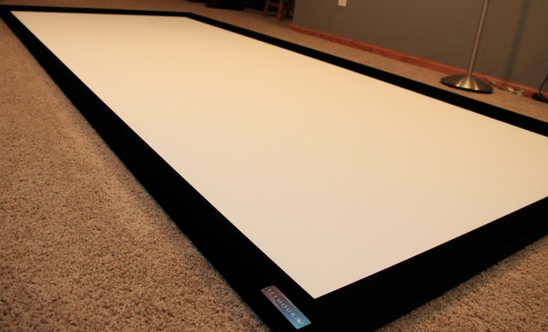

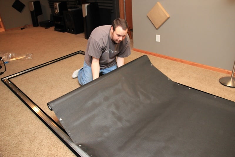

With the frame now assembled upside down the floor, it was time to unroll the screen.  Some silver looking tape held the screen roll shut, but it wasn’t duct tape.  It peeled off perfectly leaving no residue at all.  The black backing was rolled up with the screen material, so it was obvious which side of screen faced out.  While both sides of the screen material measure the same, it’s recommended that the inside surface of the roll be used for the image side since that is the side inspected for blemishes.  Some may prefer the look of the “alternative” side, so you can use that if you prefer or if for some reason you blemish the other side later on.
unrolling

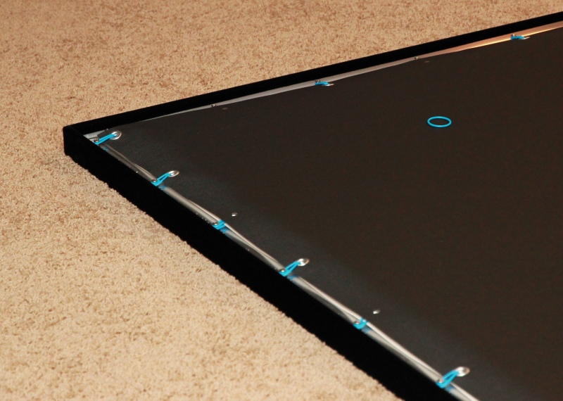

Once unrolled, there was a bit of the silver clean tape over the grommets at one end to protect the grommets from marking the screen.  At this point, the blue rubber o-rings were looped around the grommets on all sides to attach and stretch the screen.  It didn’t seem to matter which order I added them, but I did notice that the black backing only had grommets for every other hole instead of every hole like the actual screen material.  I assume this saves a little cost on the end of SeymourAV, but also keeps the majority of the tension on the all-important screen layer.  Once fully banded, the black backing had just a few minor waves, but when lifted to the vertical position, the front of the screen was perfectly smooth and even.
o-rings flat front

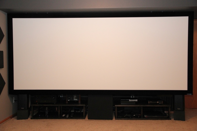

The entire mount and build process took around 2 hours, but I was taking photos with my wife and examining all the little details for the review.  I think if I were to build one again, it would be an hour or less with a normal wall hanging, even if I had had no assistance at all.  With the impressive and sturdy corners, the very flat screen surface, and included mounting hardware make for an easy install and tough screen!  I do have to note that even though I didn’t personally try it, the Seymour AV website has a video of Chris Seymour’s daughter jumping up and down on the screen material, so it should be able to withstand the likes of children on your walls.

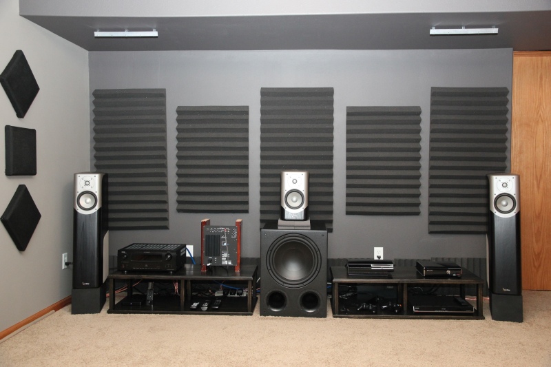

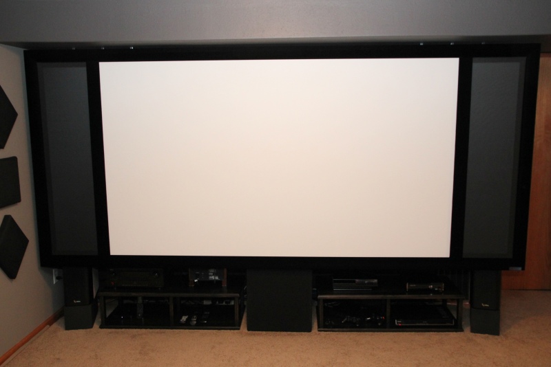

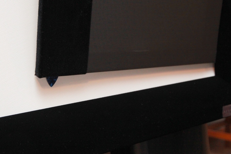

gearMy personal install required the help of a friend to lift and hang the screen due to its size.  I personally wanted the largest screen I could fit in the space, and it hung in front of all 3 of my speakers.  I ordered a 2.4:1 ratio screen instead of the 2.35:1 screen listed on the site, but the price was the same with the minor ratio change.  Also, because of hanging in front of all 3 front speakers, I wanted to have some side masking panels for normal 16:9 video, but they had to be acoustically transparent as well due to my speaker placement.  They came boxed separately from the screen due to their shape and no assembly was required.  After the screen was hung, you simply insert the bottom edge of the panel with the placement pick in between the screen and the frame, push the panel up and it just snaps into place via very firm magnetic force.  Neodymium magnets on the sides of the panel and screen frame hold the top, bottom, and side in place and there was a pretty cool Seymour AV guitar pick screwed onto the bottom of the panel along with a sticker on the back side so you know which panel to place on which side.  A small amount of force was needed to snap them back out and they side nicely at the side of the room when we watch full cinemascope movies.  I should mention that not even my behemoth Elemental Designs subwoofer causes them to rattle while hung.
add panels
 screen panels
