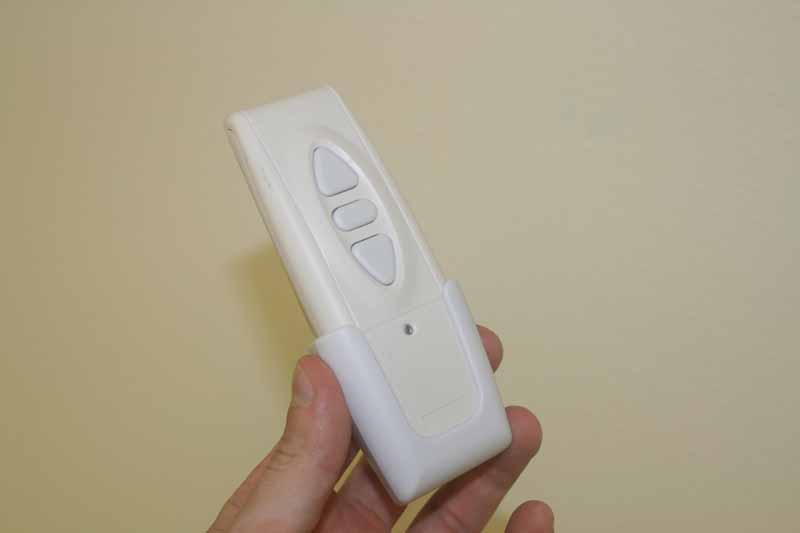

focupix-rf-remote.jpgWhat's nice about an electric screen is that it opens up the possibilities. Focupix added some real niceties that stirs the pot and brings a lot of value to consumers:
  • RF remote
    Both a blessing and a curse, an RF remote is included in the package. While this leads to exceptional performance without requiring line-of-sight, there are some trade-offs we'll get to later in the review.

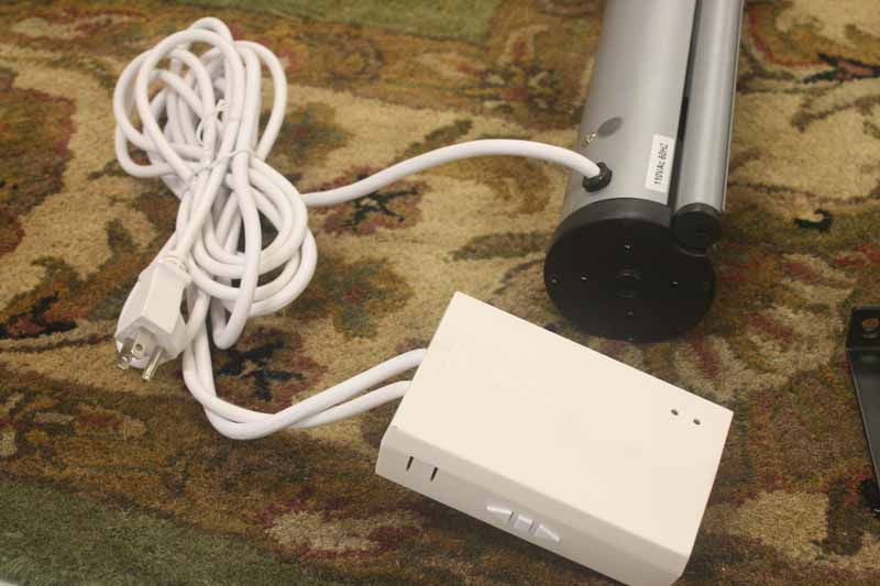

    Rather than leave users in a lurch with an RF remote and no other way to control the projector, Focupix opted for the more convenient and safe hardwired backup - just in case. This is also the box which receives power for the projector and feeds it to the main screen. You can easily wire a hard power line to it, allowing for an almost endless amount of installation options which do not require a dangling power cord.

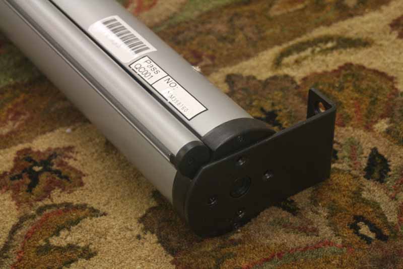

focupix-mounts.jpgThe electric screen system came well-packed, in a box that had Styrofoam surrounds to protect the main unit's aluminum enclosure. The main system was wrapped in plastic and didn't show any signs of wear from the shipping process. Once I pulled the unit from the box, I quickly realized that Focupix had put a lot of care into the design of the projector screen. Taking a close look at the mounting hardware I noted that the system used four machine thread "bugle head" screws which mounted flush into the wall/ceiling bracket. In addition, the center of the bracket had a hole which overlaid a circular nipple which centered the projector system and ensured that there could be no slippage or misalignment of the screws.

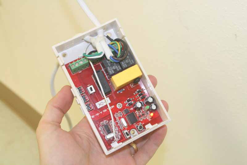

focupix-controller.jpgThe manual controller and power box was housed in a plastic enclosure which didn't look terribly modern, but provided a good access point for AC power. The controller also gives the user a reliable backup plan in the event that the primary RF remote is misplaced. I would have liked to have seen a slightly more robust set of connection terminals, as romex would undoubtedly be difficult to insert into this system - putting way to much tension on the screw-down terminals. A metal box with a rear-access option and metal screw-down terminals would have made this the perfect box for hard-wiring the screen.
