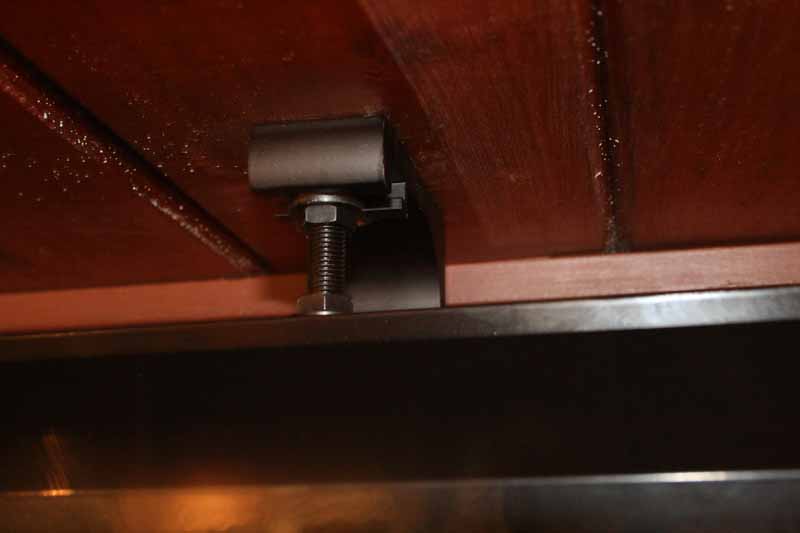

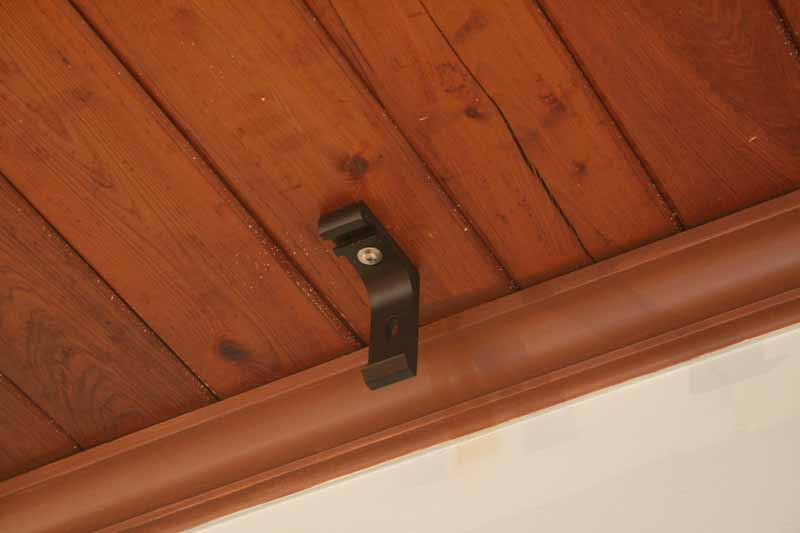

wall ceiling bracketWe were placing this screen into a 7.1 studio theater used for mixing film scores among other things. Our overall experience installing the CineTension2 confirmed that the whole process was actually quite simple. We were able to easily insert the included bolts into the slide channels along the top of the screen's aluminum enclosure. We tightened the lower bolts just enough that the assemblies could still slide along the channel but were not so loose that they'd fall out during installation. Next, we measured where we needed our L-brackets using a tape measure and a pencil (and, of course, a ladder). We affixed the brackets to the 3/4-inch tongue-and-groove wood ceiling with wood screws and a washer. Everything was level across the ceiling so we didn't need to worry about unevenness so long as everything was similarly adjusted in terms of the height of the bolts on each bracketed end of the screen. Next, we just lifted the screen into place (a two-man job) and hooked the rear of the projector screen onto the L-brackets while we slid the bolts over to catch the bracket's top channel.

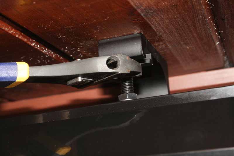

At this point we were able to simply use an adjustable wrench to tighten the bolts securely to the top of the bracket so that it wouldn't fall out. At the same time, we kept the lower part loose so that we could perform the next steps and retain some flexibility of horizontal placement.

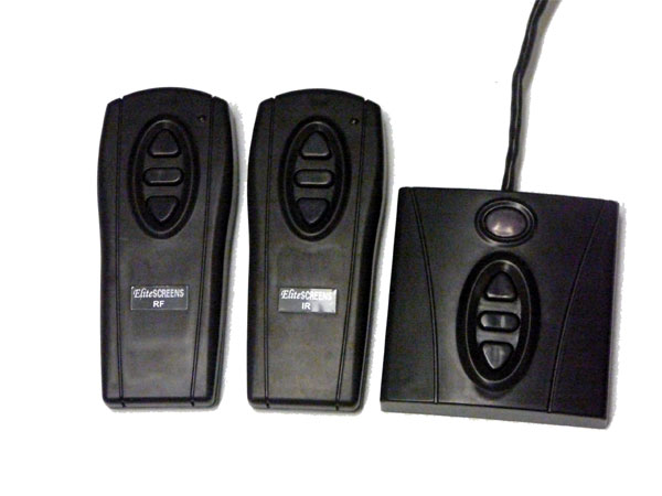

The control options for this screen are limitless, and most everything is included, save for a wireless 12V trigger - and even that is an optional accessory! We opted to use the RF remote and mount the included holster to the wall near our entrance. This saved us the hassle of mounting the 3-way switch, though honestly that would not have been a big endeavor and we may do that at a later date. With control in place, we began our viewing tests.

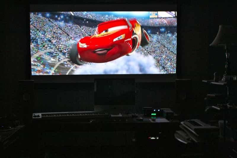

We viewed several different images on this screen, including some test material and movies like The Bourne Identity and Cars. What we found was that the Elite Screens CineTension2 did an excellent job at conveying a high contrast ratio in our light-controlled room. Colors popped off the screen and the dynamic range of the images gave them excellent depth. Blacks were able to attain rich, deep levels when the picture content exhibited low average light levels and the images could also get exceedingly bright when the demands of the on-screen images required it. This is a fantastic screen and we loved how the edges were perfectly square and crisp, with none of the curling inherent in non-tensioned models.
Cars dark room
We were able to achieve a near-perfect calibration on this screen with our projector and at no time did we notice any hot-spotting or any areas of the screen which produced uneven light coverage. The CineWhite seems to be a very reliable and dependable screen material.
