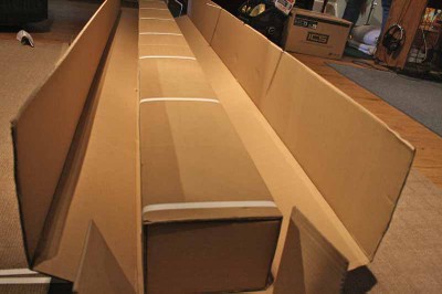

The Elite Screens CineTension2 screens are made with an aluminum chassis and are shipped in a well-protected box (we noticed no damage and the screen looked to be very much surrounded by foam and packing material as well as very stiff double-cardboard that could take a beating.) While the specs called for a bubble vial for leveling the projector screen, Elite actually included a full torpedo level that could be used as a decent tool following installation (we've never seen this before). It was a nice touch and reflected the way the company went a little above-and-beyond in making the installation process that much simpler and convenient.
unpacking box

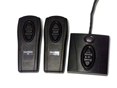

The control options for this screen are limitless, and most everything is included, save for a wireless 12V trigger - and even that is an optional accessory! We opted to use the RF remote and mount the included holster to the wall near our entrance. This saved us the hassle of mounting the 3-way switch, though honestly that would not have been a big endeavor and we may do that at a later date. With control in place, we began our viewing tests.
CineTension 2 remotes
